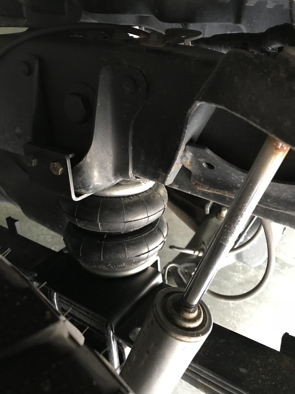

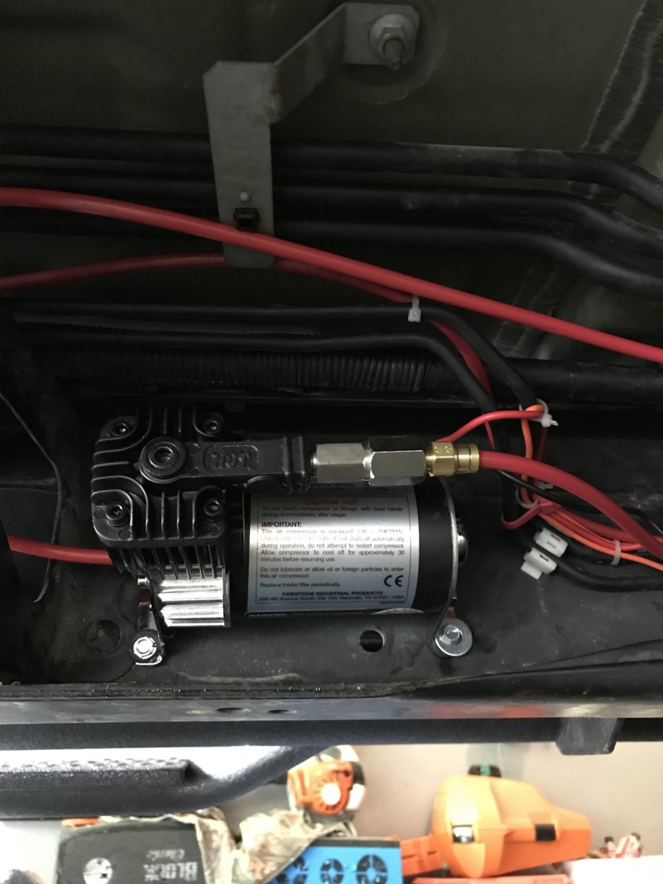

  7. Sep 9, 2018 at 2:07 AM
    buckhuntin-tacoma
    buckhuntin-tacoma Shed hunter
    Dec 10, 2017
    #238191
    13,991
    Dennis
    Quincy IL
    2014 Spruce Mica Tacoma DCLB
    Here’s a picture of mine! No cradle’s on mine.6151203F-4E14-40E1-821D-FE3B764DB2A3.jpg5E0E76C7-B7C8-43F8-B5FD-1EAFC190EA3F.jpg
