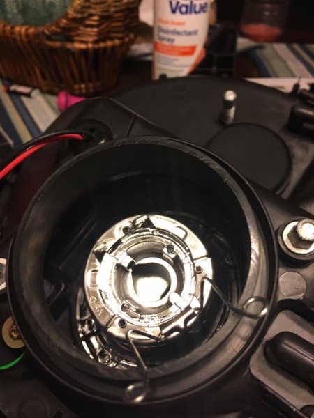

    So I bought this assembly:
    http://www.carid.com/2012-toyota-tacoma-headlights/spyder-projector-headlights-83736413.html
    which labels this as a LED assembly.
    I ordered these bulbs since the sales person said the original bulbs were pretty weak:
    http://www.carid.com/lumen/lumen-plazma-led-lights-10064457.html
    I ASSUMED that was all I needed. The original bulb was a standard halogen lowbeam bulb. As it turns out, the new LED bulb was too fat to fit into the housing completely, so I had to bore out the lip so that the bulb could slide in. No big deal. 4 dremel stones later both are done. I spend 2 hours figuring out how to remove the factory headlight assemblies and install the others. I plug everything in and it all works. I notice that the light isn't too impressive but shrugged it off as it was still daylight.
    Skip to the evening when my girlfriend and I take it for a test drive to see how it works. I wanted to punch a brick wall. Driving down a dark road with my lights on was like I was driving with no lights at all. I didn't know if it was the built in "wall" I will call it blocking the primary front light source on the bulb from firing outward in the projector lens or something else. The bulb and assembly were simple plug and play, but the light output was underwhelming.
    QUESTION: Do LEDs need an extra (amplified) power source to fully illuminate or should the stock lighting harness in the truck be enough? Remember, these were my primary low beam headlights.

    Besides boring out the housing to slide the bulb in, I did not have to adjust anything. I will have to end up finding a legit pair of LEDs to install and will certainly look at the options you are! Other than that the assembly install was quite simple, once i could get the old ones out. I believe the bolt clip on the OEM assembly (the bottom "foot" that sits close to the wheel well) needs to be used to secure the new assembly. I figured this out after i put the other one in and didnt feel like taking it out to place on the new "foot" yesterday though i plan to fix it later.

    Well, spyder housings are some of the lowest quality you can get. They look nice. But don't perform the greatest...
    I can't find any information saying what bulb type it takes, but I'm guessing it's gonna be h1. And even being classified as "led" hoysings, they are halogen. When they say led, they are referring to the led running lights. My first gen spyder housings are called led even though they take halogen bulbs. That being said, I believe, that aftermarket true led housings are not a thing. Only some of the newest cars are running factory led headlights and they are far more advanced as well as using multiple led's and optics to produce a good output to compete with hid. Because as far as I understand it, led still has not surpassed hid. And with THAT being said, you have one led source for output per headlight with that h7 "led" bulb (even though it uses multiple led's in it) it's still only producing light for a single source being the single projector per headlight. On top of that, it's so low power it's acting like a running light. Most led bulbs are only efficient enough for running light applications. Some have used the high power led kits with ballasts just like the hid kits, but still don't come close to the output of hid kits especially when used in higher quality projectors..
    So with all that said, I would have gone with an hid kit for those. Because led kits still aren't up to oar, or if they are, they don't last very long. That's not to say hid don't have issues, but he performance offsets the minor issues like a single ballast replacement or relay issue. Led kits can have all sorts of issues on top of not performing as well as hid..
    So since you cut them up, you might be sol. Unless you can still retrofit an hid kit with the same bulb type you cut it up to fit. Otherwise I'd be contacting the company and complaining big time for false/insufficient advertising. But since you cut them, they probly won't be so happy to help you out since you didn't contact them first regarding bulb fitment. So I'd say you have two options. Try to retrofit a hid kit in, OR, call theretrofitsource and see if they have a retroquick retrofit for those, where you can completely remove the projector housing inside and replace it with their kit (by they probably don't because they only fit certain spyder applications, but it may fit IF it's the same design). Which will come with a more advanced projector bowl as well as the hid kit. Then you can work on something better for the high beam bulbs as well because I'm sure those suck too.
    For now, I'd probably throw those led bulbs in the trash, and put in some halogen bulbs.

    If you look at the rated lumens on those LED bulbs that you purchased, you will see they are only 420. That bulb is not designed for headlights. An LED bulb that is designed to be a headlight will cost over $100 at this current time.
    Most stock headlights are somewhere around 1000 lumens a piece.

    Those aftermarket light housings have terrible light output in general, and no bulb you put in is going to fix that. Sure, you can make things brighter with HIDs/brighter halogens, but it still won't give good light output (there is more to lighting than just how bright the bulb is). If you really want good light output out of those housings, do a proper retrofit with the Mini H1 7.0 from TheRetrofitSource, or if you don't want to spend that much, the Acme H1s from TRS are also a decent option. Otherwise, put your stock housing back in, and get brighter halogen bulbs (none of the tinted crap) like the Philips X-treme Vision.
    Not what you want to hear, I'm sure, but it's the cold hard truth. Those that tell you otherwise don't know the physics behind lighting up the road.

    Sticking a bulb designed for a normal halogen housing into a projector housing and expecting projector performance is probably where you went sideways.
    LEDs draw super low amperage at the same voltage as a halogen and produce the same light. That's a fancy way of saying "This shower head has the same amount of intensity with less water due to a tighter fitting at the end of the hose."

    No. A good projector will work regardless of the same bulb type.
    Where he went wrong was skimping out and buying a poor quality housing, which is well documented to have horrible beam pattern/light output. Then compounded the problem by trying to run cheap garbage LEDs that are vastly underpowered and poorly designed in a poor quality housing and expected this to somehow be an improvement over stock.
    I always preach CAPA Certified lights, or OEM because aftermarket lights have no performance standards they need to meet. Unless you are going full $1k retrofit from a reputable vendor, chances are you are downgrading your lighting performance with an aftermarket housing.

    So I ended up putting the halogens back in and the headlights are working now as they were designed--as crappy as they were designed. They still look "cool" but don't function as I had hoped.

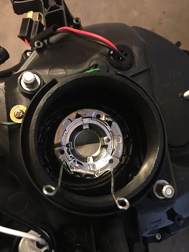

    Fyi, I think I may have misled a few of you. I didnt necessarily cut up these housing, but merely widened a hole (now it is clear it was done in vain) of the internal housing for the projector. The first picture below was the more narrow hole and the second is the wider hole. That is the only modification I made to these (so far).
