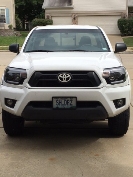

    Here's what it looks like during daylight.

    doesnt look too bad. the projectors are probably fine. you need better bulbs. HID or cree led headlight bulbs. the ones you bought are about as good as turn signal bulbs.

    Yeah, the problem is that i would need to replace the projector lens within the housing, and that requires me to break it apart and reseal it. If this is one of those assemblies that is so cheap it allows in moisture, i might look into replacing it when i break it apart to reseal. Who knows. I've got some big life projects that need financial investment and I don't know how much more I am willing and able to put into the truck. :/

    no you don't. says it takes H7 bulbs. just buy H7 HID kit or H7 cree bulbs.
    also if you don't trust the housing, but a tube of silicon caulk and seal around the edges.

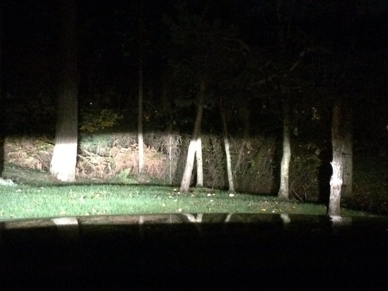

    So I got an update on my set up. I have put in the Morimoto XB 35 H7 HID kit in these headlights. After adjusting them like crazy thinking that my light angle was affecting the poor visibility, turns out it really is the shitty 3 inch projector. I am going to hit up the retro source today and see what they recommend. I will probably go the route of opening up my headlights and replacing the projectors as I have heard especially with the vipmotoz/spyder projectors that they are shit stock. OP, if you havnt bought a new HID kit, I would consider a new projector first as I think I may have to get some new bulbs for my set up as I have H7s in there now and I may need some H1 bulbs with a new projector. I will update on what I find today. For the most part I really like these headlights as they are unique and got a clean look, but these projectors are SHIT(sorry I cant stop saying this word).
    I bet if you replaced your projectors, you would be surprised at the power of just a regular halogen bulb at that point.

    After looking at a few youtube vids I realized that is normal to replace the projectors. Anyway I got off the phone with the retrofit source and they told me to get some H1 bulbs that will just plug into my existing HID Morimoto kit. From there I will get a 2.5" retro-quick universal kit. I am going with the H1 (7.0) projectors that are supposed to give me max clarity and distance as I only want this done once. You can get other H1 projectors for as cheap as $25, $50, or $130. Anyway this will be about a $200 upgrade that will make my lights more than what I already want out of them.

    That's what I replaced mine with as well, Mini H1 7.0. They're really the only high quality projectors that fit, the Mini D2S and FX-R are too large.
