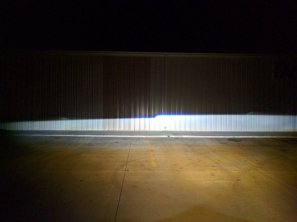

    You will like the mini H1's. Here is how mine perform w/ Morimoto 5K bulbs.

    Thanks for the photo. Im excited to get these installed in a week or so.
