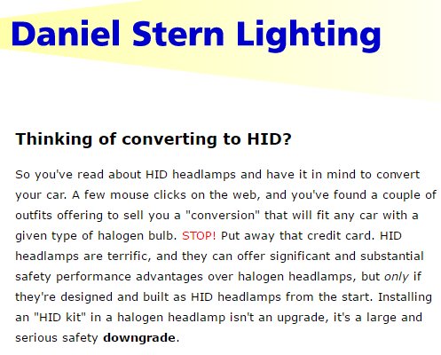

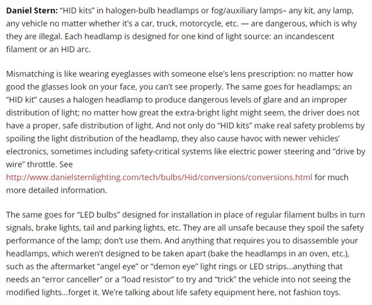

    No, clearly you do not understand.
    If you want to do it correctly, you do a retrofit designed for HID/LED light sources like the projector retrofits others have helpfully mentioned in this thread. If you want to keep the stock halogen reflectors, you do a halogen upgrade designed to work with halogen reflectors like the one listed below.
    https://www.tacomaworld.com/threads/the-ultimate-headlight-upgrade-not-led-or-hid.398066/
    Daniel Stern is only one of the most widely respected headlight subject matter experts in the automotive lighting field. For you to even attempt to mis-quote the content is a complete joke.
    If you want correct, it is full retrofits, or halogen upgrade.
