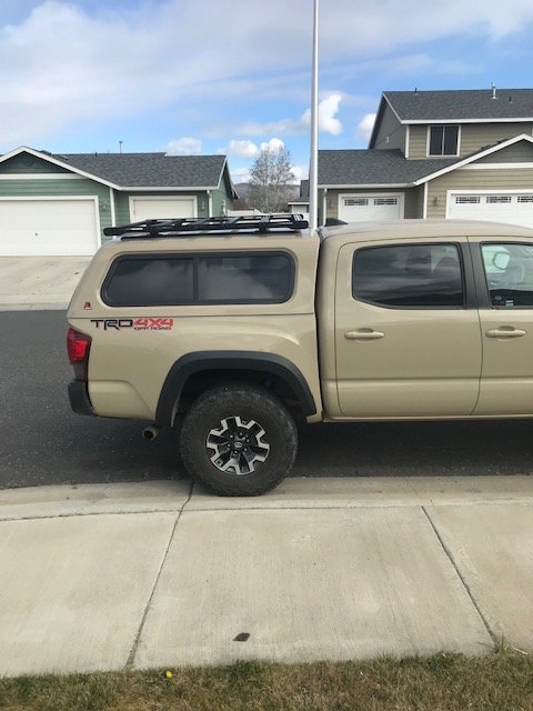

    I think it still needs to come forward more. Make it flush with the front of the bed and the latch for your door is adjustable so just mess with that to get your door closable.

    I've tried to search how to adjust the latch but couldn't find any videos, I'm a visual learner lol. If its any farther forward the bottom seal of the door hits the tail gate and latch won't catch and close.

    I'm an idiot, I see how to adjust the striker bar now.

    I think I got it. I don't know if that leer dealer hasn't worked on many Tacoma's or he just had an off day.

    The door latches should be adjusted so that there is even compression of the weatherstrip that the door (glass) presses against.
    After that, you should aim for an even seal of the door weatherstrip that seals against the tailgate.

    I would have them or an actual competent shop reseal it they did a fucked up job in the front and I already know it will leak like a sieve
