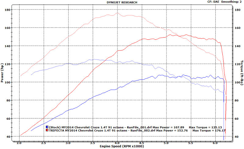

    Here, look at the VW GTI http://www.autoevolution.com/news/s...es-vw-underrates-their-cars-video-91971.html#
    Max torque from 2200 - 4500 RPM
    Stock 335i dyno - max torque from 2750rpm to 5500rpm
    Stock 328i dyno - max torque from 3100rpm to 5100rpm
    Chevy sonic dyno - near max torque from nearly 2000 rpm to 5000 rpm
    And now for comparison, a stock supra dyno, max torque from 4500-5500rpm
    And for a great comparison, twin turbo 3.5 V6 - aka nissan GTR, near max torque from 2750 rpm to 6000
    Gas engines (boosted) just cant reliably make torque below 2500rpm. Diesels cant reliably make torque over 3000 rpm :benchpress:

    Awesome thank you, these are great. If only they could get under that 2500 mark.

    generally speaking a smaller sized turbo on a gas engine makes more torque at lower rpm...as @CanadaToy showed there. I also think it'd simpler to work a turbo into the system rather than a supercharger
