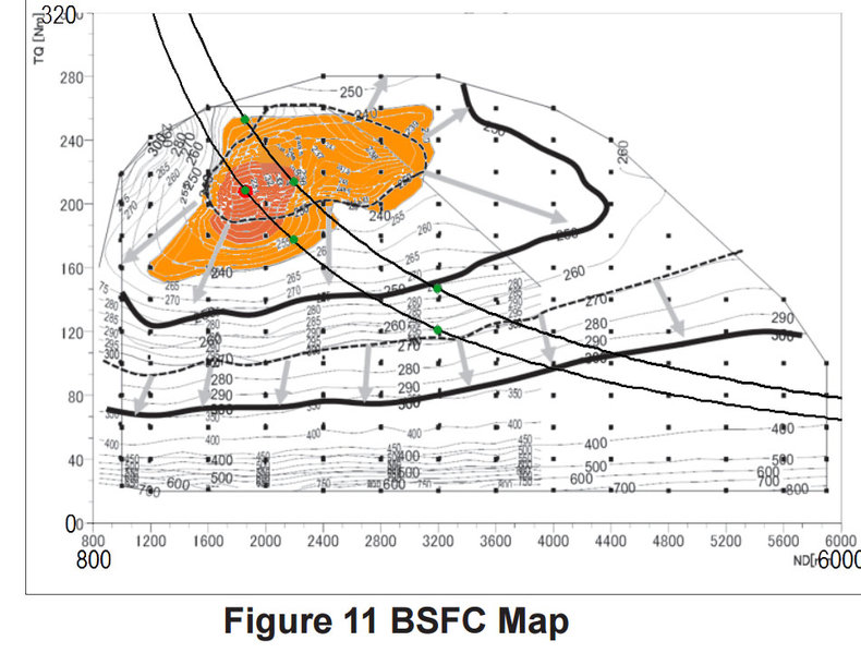

    No, this is where your intuition is wrong. Operating at higher RPMs can be more efficient than lugging it at lower RPMs in many circumstances.
    Another member (Tharris242) made this great overlay of the only publicly-available BSFC (brake specific fuel consumption) map we have for the 2GR-FKS:
    Bottom axis is RPM, left axis is torque, and the two parallel asymptotic lines are lines of constant horsepower. The numbers all over the middle are BSFC numbers. Lower numbers = better gas mileage. Ideally you want to be operating in the islands of the lowest numbers. The chart is unfortunately chopped at the top line (measuring machine limitations, most likely) but you can see that high torque demands at low RPMs don't actually produce the best BSFC numbers. So while there are many scenarios where you could lug the engine at lower RPMs and accelerate, it might be more fuel efficient to drop down a gear and let the engine/transmission move the operating point closer to that island of efficiency on the map.
    Keep in mind that 200 lb/ft of torque at 1000RPM is equivalent to 100 lb/ft of torque at 2000RPM with a 2:1 gear reduction. Your transmission's job is to deliver torque at the wheels while optimizing the BSFC. Some times that means spinning at 3000RPM instead of lugging it at 2000RPM, even though the power output and torque at the wheels is the same due to different gears.
