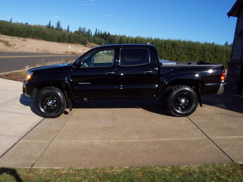

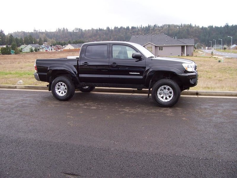

    So I have a 2012 DCSB Automatic V6 have had it about a month and the first thing I did was put on some new wheels and tires and a 1.5" leveling kit. Well that wasn't doing it for me so I went ahead and put on the Bilstien 5100's set at 2.5" a 1.5" add a leaf in the rear and some LR UCA's. Changed out the Wheels to the MB Torques and kept the 265/75/16 Cooper ATP's So far I am pretty pleased with the results. So the first picture is bone stock right off the lot, second picture is the first set of wheels and the 1.5 leveling kit and the last two are the final mods. I would highly recommend putting on UCA's if you go above 1.5" I had a buddy align it for me and the alignment came out perfect and it drives like factory. Only problem is the take off shudder and the vibe at 20mph but that was doing it as soon as I drove it off the lot now it just a little more noticeable so I will do some investigating on the drive line angles and shim appropriately. One other thing my wife who is only 5' tall already was complaining about being able to get in it so was thinking about getting some kind of nerf bar but the only one I saw that I liked I don't know the name of will have to do some searching or anybody that reads this have any suggestions for a vertically challenged women it would be appreciated and I know before anybody says anything what is she doing out of the kitchen well I asked her that and was promptly punched me in the junk and she told me to be careful or I would wake up with my sack stapled to my forehead, to which I replied I don't think that is possible and she said she would make it possible and I have to sleep sometime so she wins I will find a way for her to access my truck easier. Thank goodness she has a sense of humor.:D

    #22040

    Lookin' good.

    Normally not a fan of chrome...but those look good! tons better than those black ones with the silver caps. As for steps, look into nfabs!

    nice truck, the chrome looks good

    Just an FYI, those wheels are not chrome guys, they are silver machined. I have a friend who has them and they are nice.

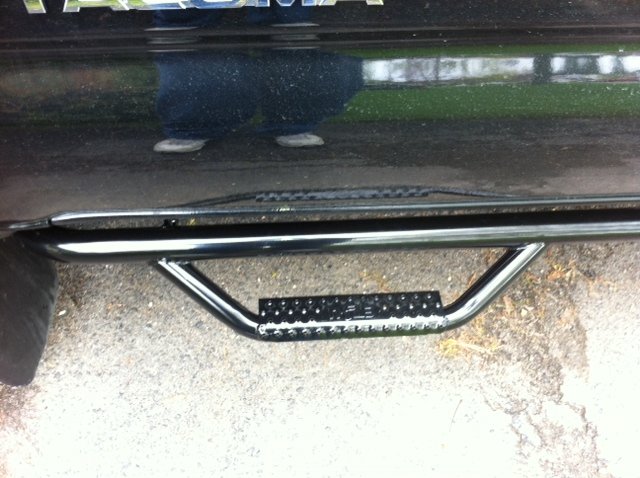

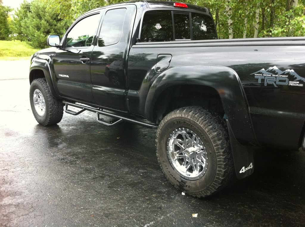

    I put N-Fabs on mine for my vertically challenged wife. She hasn't complained since. I've got a similar setup to yours except my tires are 285's. Love your chrome wheels ;) Black and chrome is an awesome combo!

    @ taco-nb thank you for the pics that is exactly what I am looking for love that look and it looks very functional.
