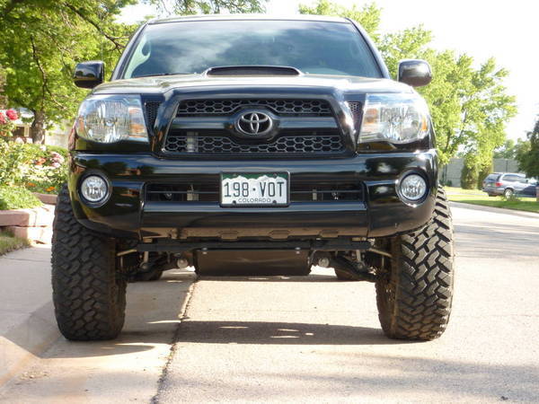

    Thats what I did for 285's. this is what I did for 295's :D
    cab mount chop.
    Current pic of the front...
