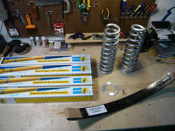

    UPS just dropped this off! Just can't decide whether to set bilsteins at 0 with eibach springs to achieve 1.5" lift or set to .85 to get about 2.5". i've heard about bad vibes at .85.....any suggestions would be greatly appreciated.

    I have the same kit and set the 5100's to .85. I have slight take off vibes from 5-10mph. I fit 285/70/17 duratracs and just had to trim a little.

    I just installed mine, with the front set at 0". I was wary of the vibes that might have happened at .85 so I kept it at 0 for now. Rides great, no vibes.

    I have Bilsteins at four corners set @0, with Eibach springs and 1/4" shim on driver side. Rear TSB leaf springs. Ride is great, no vibrations and alignment is spot on. I will be going with 265/75/16 tires and FJ rims after holidays. I gained 2" in front on my 4x2 DCLB after the lift. Hope this helps.

    I have the same setup on my PreRunner:Eibach's, 1/4" driver's side spacer, 5100's on all four corners with the front set at 0, Toytec 1.5" TSB add a leafs on my non TSB springs. The rear has not settled much at all, so I have a little rake. The only vibes that I have are right at 20 mph and they are very mild.

    I have the same thing set at 0.85, and got a bit of vibes from the AAL at 40mph... installed the OME carrier bearing and it got rid of the original factory take off vibe, and 99% of the vibes the AAL was giving me. Happy camper now :) Pics of mine in my gallery.

    Ok so I see a lot of these vibes at .85 isn't it just because the driveshaft is at a harder angle?
    You could just get another drive shaft, SYE kit, or TC drop (TC defeats the purpose of lifting though) I came from jeeps so correct me if Im wrong.

    i have almost the same setup i have them set at .85 with a .50 on the drivers side and .25 on pass with the tsb aal from toytec with the c/b drop and axle shims running 285 m/t's and i have zero vibes.

    Lifting only the front won't change the rear drive line angle.

    i think 2 inches is the max before you start running into issues with vibes and or angles of drive shaft and cv joints. this is what arb tech told me yesterday and icon told me the same thing as well a few weeks back. i think i'm going old man emu for my lift they are saying it provides a solid 2inch lift thats all i think i will need. i'm unfamiliar with the setup you have there but i know its a good one. if you can try and set it at 2inches or just a tad higher to avoid any real vibes and or issues.

    New UCA's for 2"+ lifts isn't really a recommendation, it's simply a common need due to alignment caster issues. There are tons of people who run 2.5" with no alignment issues.
    And why not try .85" first and see what happens? If you get vibes, you can always go back to 0". You'll never know if you could have gone higher if you don't try, right?

    New UCAs for ANY lift is a good idea if you actually plan on wheeling....for travel purposes.

    Which is fine...some people lift and never leave pavement, and 2" or less shouldn't need aftermarket UCAs. However, they do help travel, and that can help ride quality on road as well.
    They have benefits...whether or not those bennies are worth the cost is a whole new ballgame...
    Also re: vibes and shit: It's either going to happen or not, and there's no sense in worrying about it. Either accept that it might happen and you'll have to troubleshoot it or don't lift.
    FWIW I did 3" on the money and all I had to do was shim the CB to lessen some takeoff shudder from 5 to 10 MPH. It's still there, but no worse than the takeoff shudder I already had from the TSB springs. I'm not concerned and plan to leave it be.
