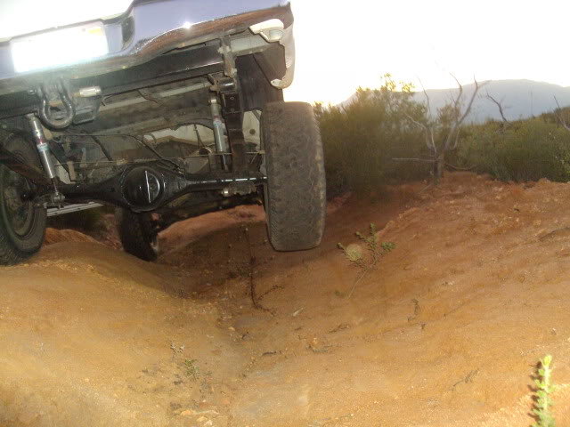

    This amount of flex with my OME Dakars
    Left me this much slack in my stock brake lines
  12. Jan 12, 2012 at 9:49 PM

    Your still a good 5 or 6 inches from full droop in pics OZ, & whats in your hand ain't gonna cut it when it does I fear.....
