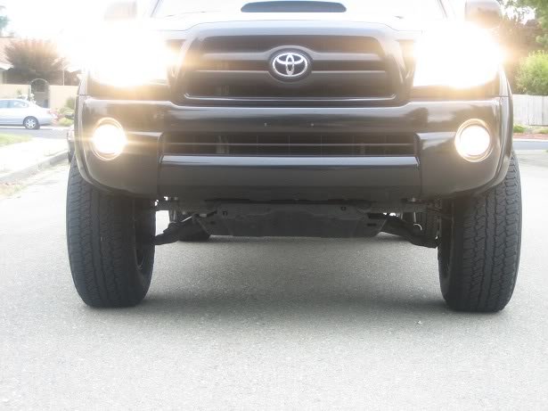

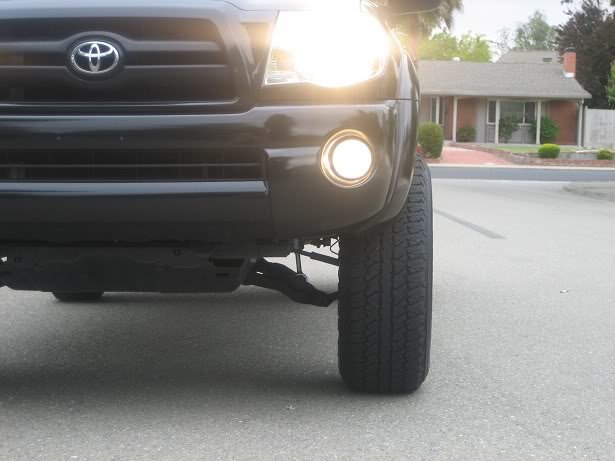

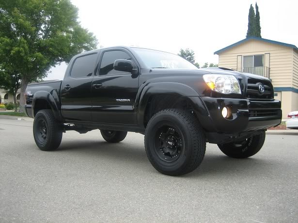

    Hey guys I just lifted my truck with the 5100 bilstiens set at 2.5" and 2" AAL. I put Moto Metal rims wrapped with 285/70/17 Firestone Destinations A/T. I LOVE how it looks but I have a few questions. I ran stock tires with the lift for over a week with no vibrations. Well after the tires and alignment Im getting a steering wheel vibration around 45-55mph. I know its not an alignment issue and I know its a most likely a balance issue. Well the guys that did it said the tires are balanced and its something I have to deal with having 33" tires and a lifted truck. Also the camber looks a tiny bit on the positive side. I know caster is a problem with lifting the Tacomas but I thought the camber should be able to be in specs.
    What do you guys think? Thanks in advance!!

    Does the camber look alittle off?
  4. Jun 9, 2010 at 7:20 PM
    mnudo200827
    mnudo200827 Well-Known Member
    Oct 31, 2009
    #25224
    357
    Michael
    Corona, CA
    2005 Tacoma Double Cab Prerunner
    Icon Coilovers, All-Pro UCA's, All Pro 3" Leaf Springs, Rear Fox Adjustable Shocks, Stainless Steel Brake lines, 17" KMC Addicts wrapped in 305/65/17 KM2's, Kenwood DDX 512 stereo, 2 12" Polk Audio MM1240 subs in custom enclosure, 4 component speakers, Wet Okole Seat Covers
    ever so slightly.
