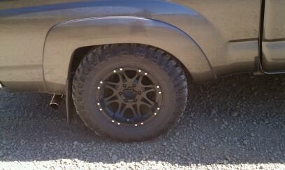

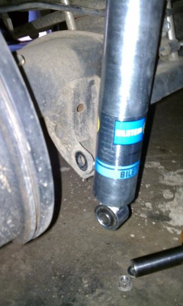

    Thank you for all your help DSM and Toytec, I would recommend using either company. Truck specs: 2010 taco, access cab sr5, NO rear tsb, 285/70/17 Dick Cepek Tires, matte black Raceline Raptors. Here are the parts used:
    From DSM:
    Bilstein 5100's front &
    Bilstein 5100's Rear '99-06 Tundra fro 2"-3" Lift part # RCD-BE5-B110-T5
    From Toytec:

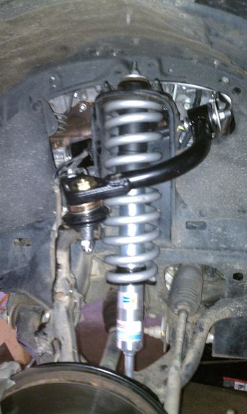

    Toytec/Eibach front coils.
    Light racing uca's.
    Front 1/4 spacer to fix driver side lean.
    Parts used from old fatbobsgarage.com spacer lift:
    2in leaf
    Front diff. drop kit
    U Bolts.

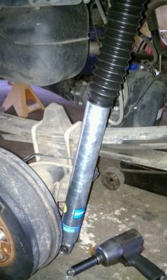

    Overall I'm very happy with the performance of the lift on and off road. Drives a lot better than the spacer lift. The rear shocks are very smooth and make the truck have a slight rake. However with the added weight from my canopy (when I put it on again after I paint it) the truck sits almost level. one side note: I had to use a floor jack to compress the rear shocks to install them.

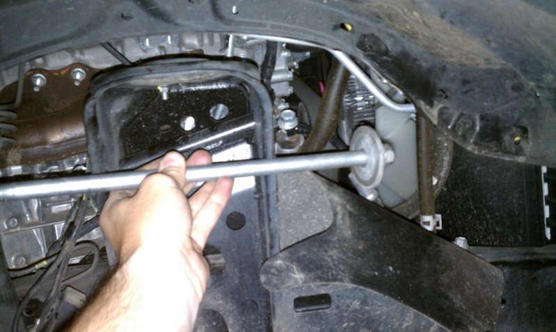

    My only concern was the removal of the factory UCA in the first picture you can see me holding up the UCA bolt. Did Toyota put my bolts in backwards? You can see the discoloration of the sheet metal where I had to bend it to remove the bolt. When installing my Light Racing UCA's I simply put the bolt in from the other end. That should be fine correct? Has anyone else had this issue removing factory UCA's? If so did you cut the bolt, bend the sheet metal, etc. etc.?

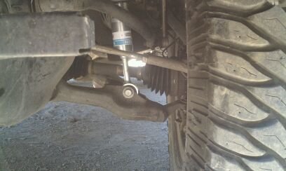

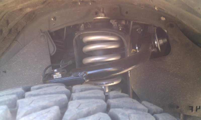

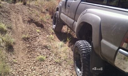

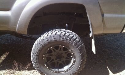

    Here are some pictures of cv angles, a little baby flex, and some installing shots.
    Let me know how everything looks or if you have any questions!

    Damn I didn't even think of greasing. I cleaned everything throughly though. The whole process was a learning experience to me. I'll grease them up soon.

    i wonder why the Valving is so stiff on the 5100's, I collapsed my foxes with no difficulty to install them?

    wait you said it was extremely difficult??
