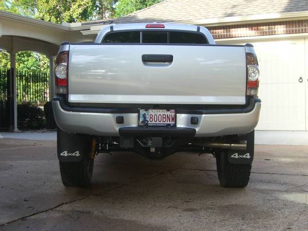

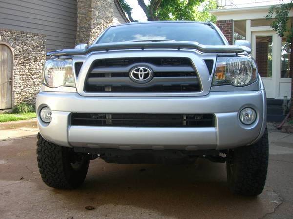

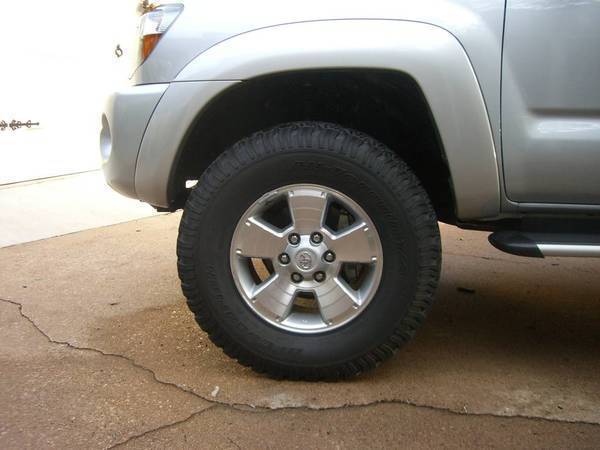

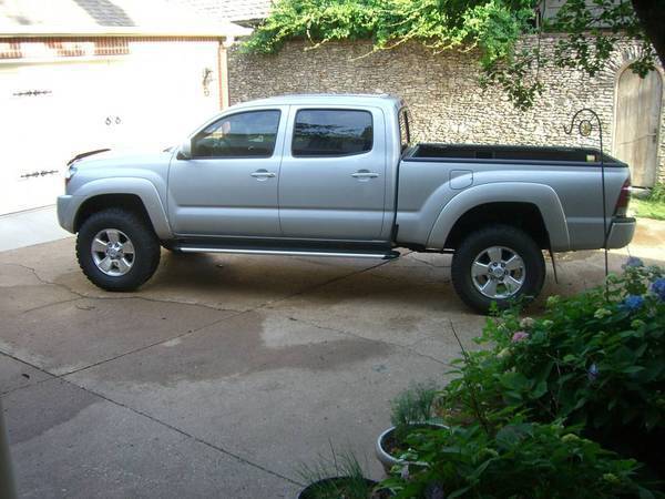

    Hey - just leveled with Bilsteen 1500 @ 2.5" in front and Toytec 2" AAL in back. Changed wheels from crappy OEM to BFG AT 285/70/17. Kept Sport 17" rims. Had to modify front to stop rubbing with 2.5" wheel spacers and carved out some black plastic with a razor.

    My ride feels softer than original. Toytec sent front mod (spacers) so no other mods needed. I had it aligned and now I go down the highways and streets straight.

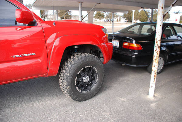

    Heres what I did. You basically gotta get rid of the black inner plastic with a pocket knife. Mine was probably more drastic than his because mine are M/T's. Either way, you can see it up front of the tire in this shot.
