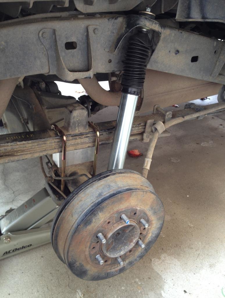

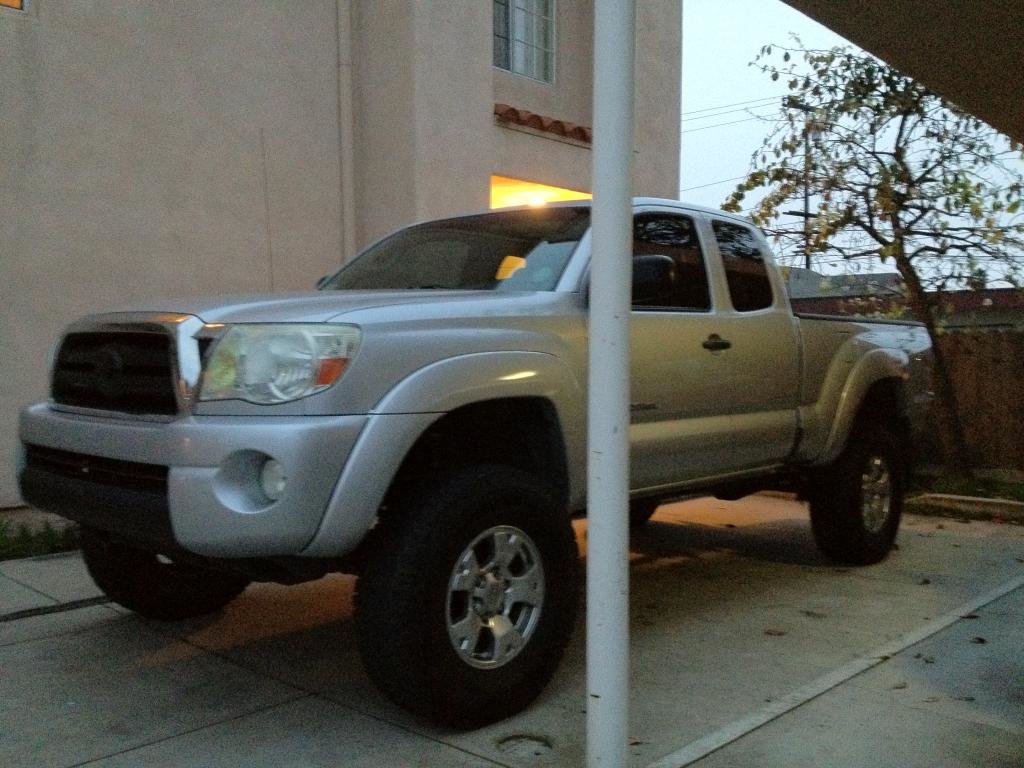

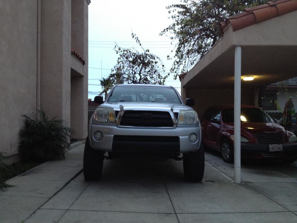

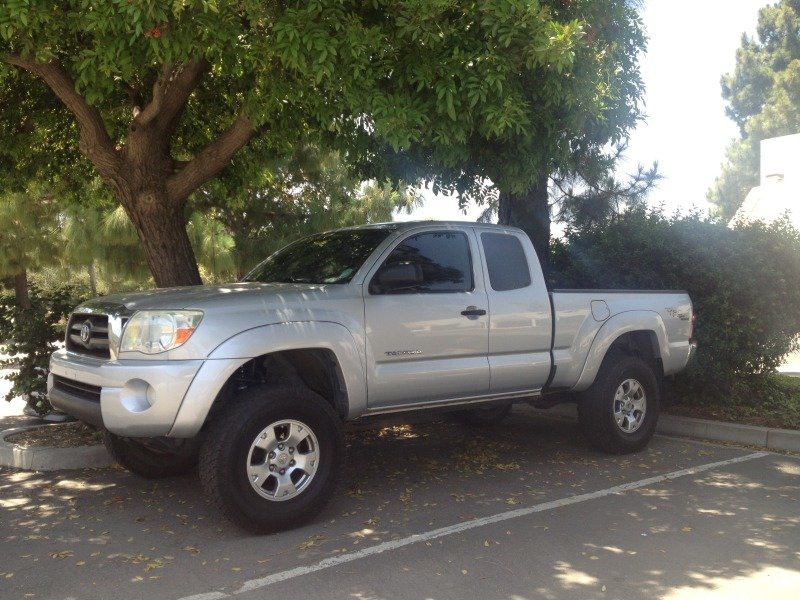

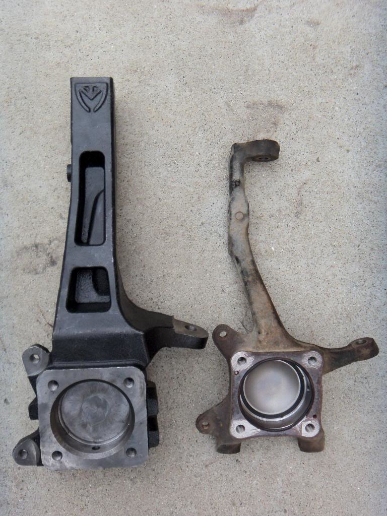

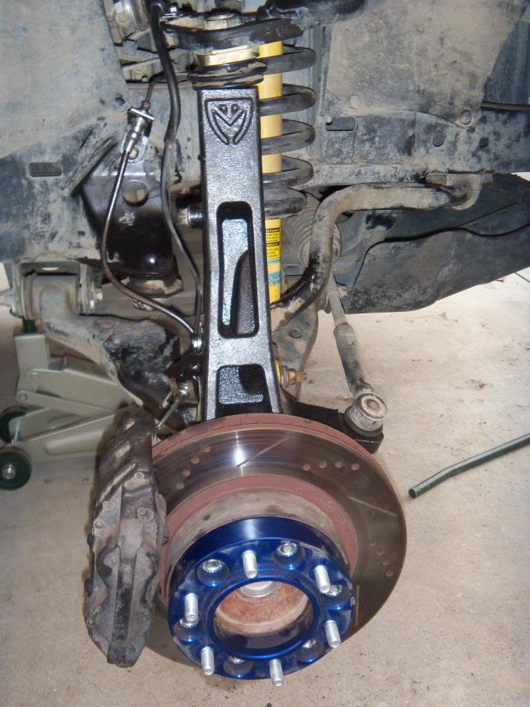

    So I've be running PC 3" lift coils with ES6000 struts up front and a Wheeler's 1.5" 3-piece AAL in the rear. Today I, tentatively, finished my lift upgrade. I went with 2" blocks in the rear, for now(I said tentatively. I will be getting All Pro standards in the future). And Maxtrac 4" spindles up front. Got rid of the PC coil lift and went back to stock TRD coils with Stock Billys. Took me a little over 6 hours by myself. Few pics below.

    Prerunner(2WD). You can't do spindles on a 4X4. At least none that I know of. You have to go with a coilover lift for 3" max or a full suspension modification including crossmember cutting(Pro Comp, Fab Tech) for a 6" lift.
