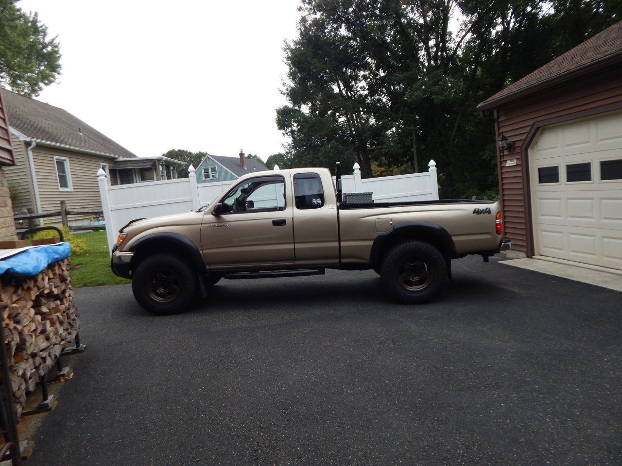

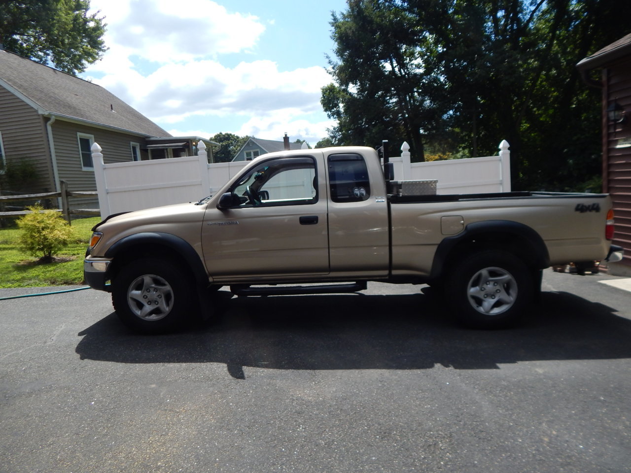

    :cool: I finished putting the struts back together yesterday.I used the stock front coils with the 4 position Bilstein 5100s set on the 3rd position.Before I was running the Monroe Quick struts and Cooper 245/75/R16 tires. Now I have the SCS F5s with Pirelli Scorpions 265/75/R16 tires. I gained 3" up front and about 1 1/4" in the rear. It's somewhat taller than I had planned,but I think it looks great. I had the wife try the passenger seat and did good as we are senior type folks. What do you think? Frank

    I did similar on my taco and love the slight lift. Yours looks great. Jumping up into your seat keeps you young!
