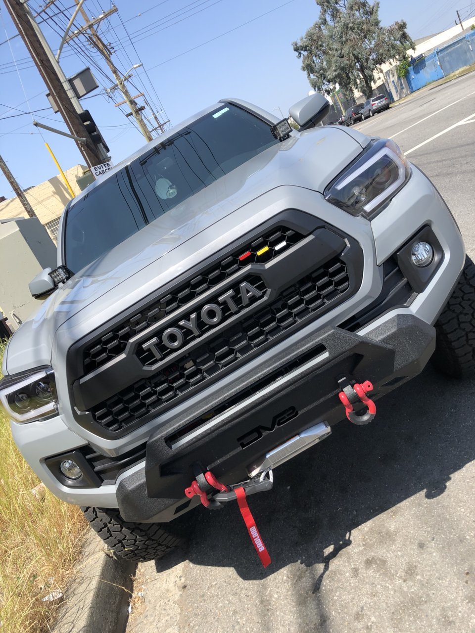

    When I test fit the bumper, I noticed that the winch cable rubbed the plastic of the bumper and was at a bad angle to the fairlead. So I cut the DV8 logo out of the bumper, cut it out longer and drilled holes for the fairlead. I then cut the old fairlead slot to match the access holes on the sides and made a large access hole right under the winch. This is what it looks like now, just installed it tonight.

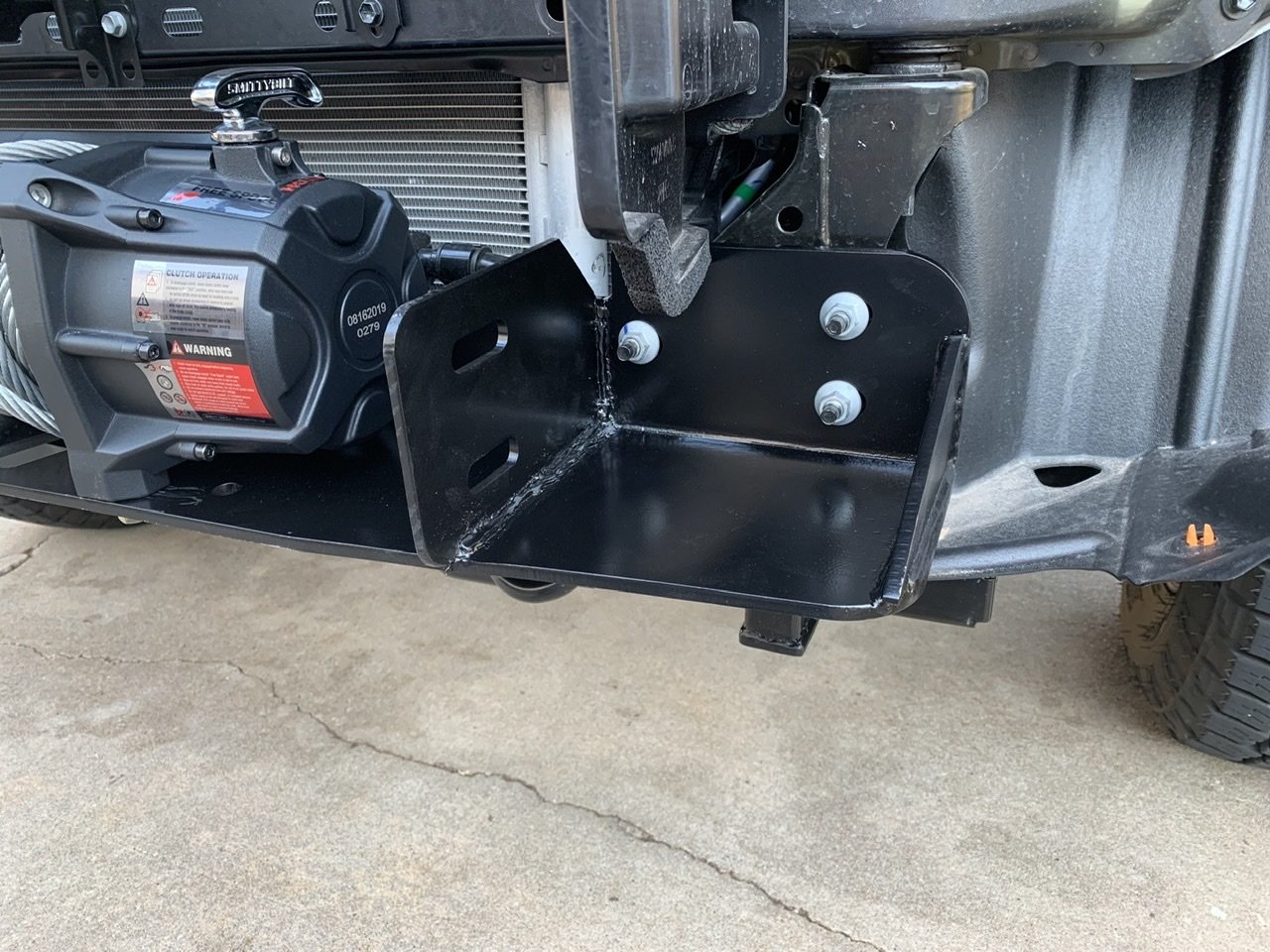

    Here is a picture of the winch bracket modification. The original had two angle brackets that bolted along with the winch plate to the three bumper bolts. The assembly was so thick that the nuts did not thread fully onto the bolts. I ended up welding the brackets to the winch plate. This caused the bumper to not flex as much when under load. Also welded a brace that went down to the slip tube bolt to spread out the force from winching.
    guwoptaco and BSK like this.

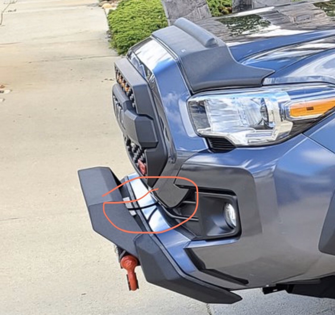

    Those of you with light bars installed, how are you running your wire, or is it exposed like this one (not my truck)
    i am considering making a hole inside of the weld to run the wire through, but want to avoid it or get some info on it from someone who’s done it.

    I had to drill a hole through the pocket that collects water in the bumper and feed the wire through. I also drilled weep holes in that pocket to drain water. Once you feed the wire through the hole it is inside the bumper and can’t be seen. I would take pictures but it is hidden. Cheers!

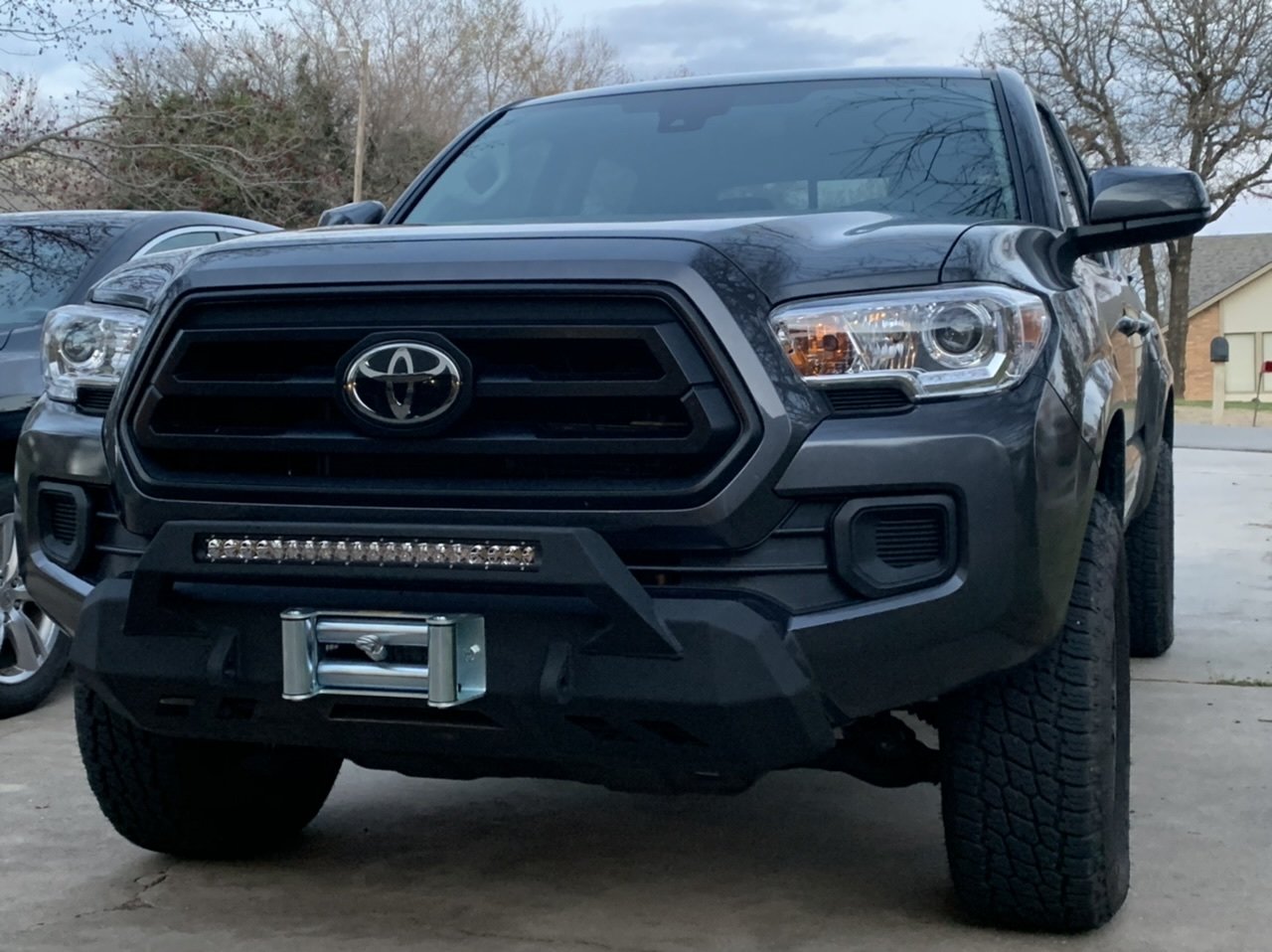

    Has anyone with the front camera I stalled this bumper? Does it effect the 360 or front view?

    I did, I mounted the camera high up on the grill to get a good view although the light bar gets in way a bit
