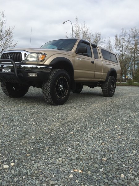

    I'm looking at getting some 16x8 pro comp wheels and 33s, I was told with my current lift that I'd be able to fit them and no rub

    With a 3" lift, you'd be able to squeeze in 285/75/16s. Depending on the backspacing, you'll most likely have to remove the front mud flaps (looks like you already did) and have to slightly trim the fender flares. And if you go off-roading and flex out the suspension, you may want to look into a cab mount chop and the pinch weld mod.

    It's got a 3inch in the rear and leveling kit in the front, based on what 4x4 parts said it should fit and yes the end all beat all goal is to be able to off road as well as my daily, next will be a body lift. The rims on it right now have little to no back spacing. I got a good deal on the truck just need to fine tune some things
