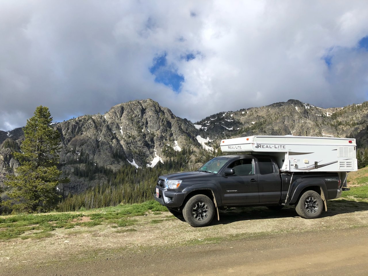

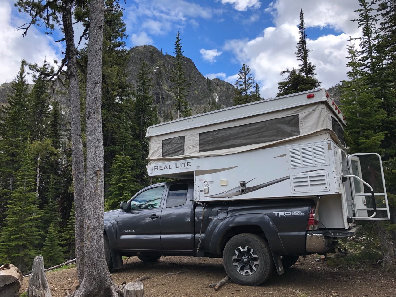

    +1 for the firestone riderites. They keep the truck level and help maintain handling.
    My camper weighs in around 1k dry:
    8ED4841D-20A1-48D4-B37E-7F1A927D4B65.jpg B40707E4-086A-4871-ACF8-FBBF9231AD05.jpg

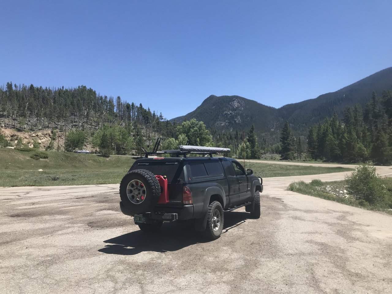

    Heres mine with the firestones and about 550 lbs of added weight
