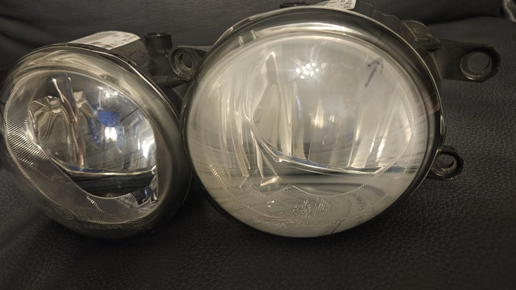

    Seen several posts about 3rd gen Tacoma headlights, I agree they are the worst. I have a 2019, when I bought it new they were almost adequate, now, 5 years later, they are terrible. The high beams are okay, but the low beam projectors and fog lights are just a white glow, good for about 50 feet. I cannot drive on a freeway without using my high beams, it's not safe at any speed over 45 mph. I have replaced bulbs, does not make a difference. The fog lights are looking like a frosted light bulb, the inside of the projector lens looks the same when a flashlight is shined on the lens in the daytime. Bought some aftermarket fog lights, I can see three times farther with these after market fog lights than I can with the low beams and new bulbs. Bought some reflector dish headlights to replace the crappy Toyota lights, will post the results after installation. How many other 3rd gen Tacoma owners have this issue? Will try to attach picture of fog lights, attempted to clean the inside of one of them with eye glass cleaner, but there is still a haze on the inside. Same haze is on the inside of the projector lenses.
