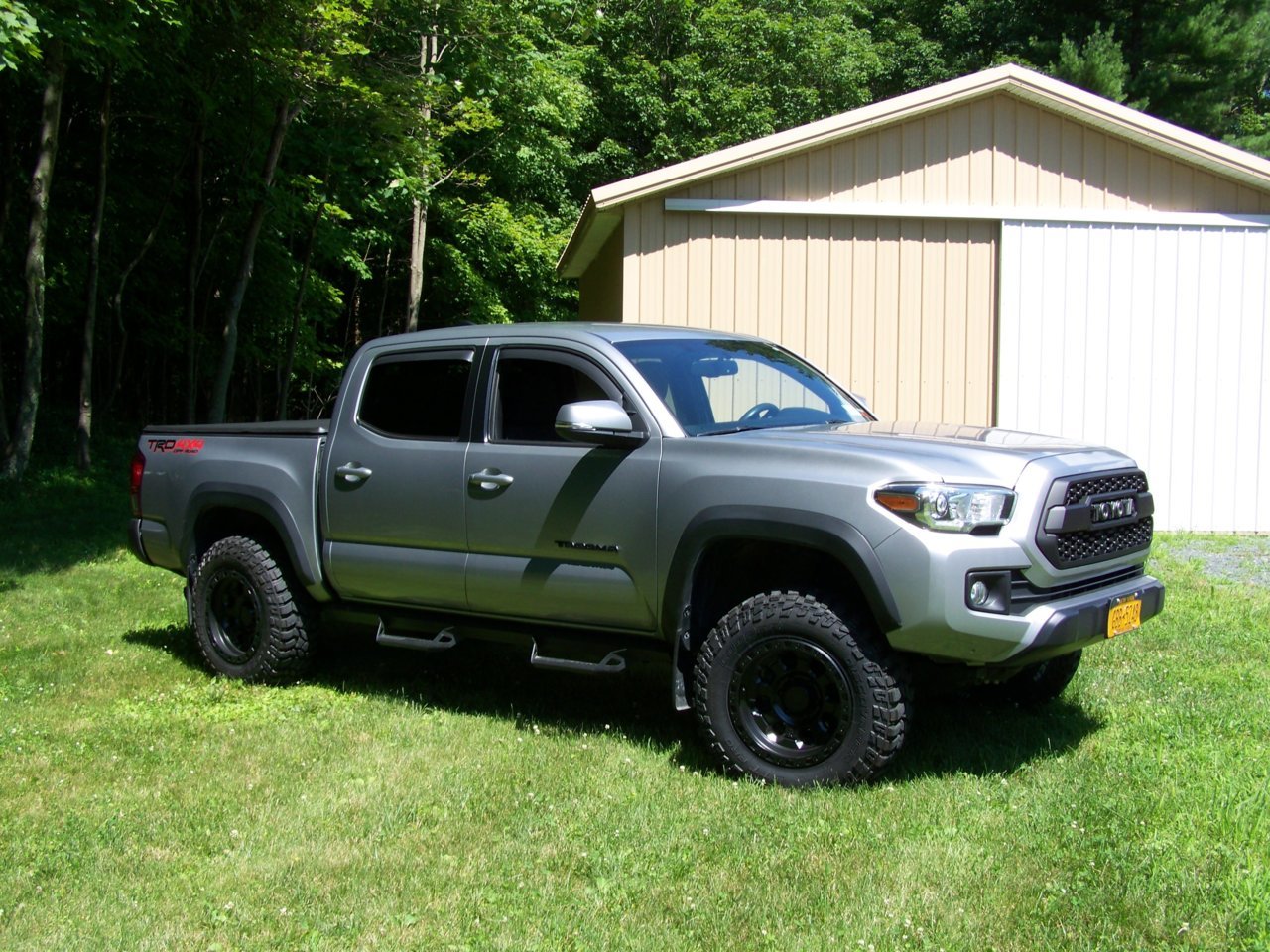

    2016 Silver Tacoma TRD Offroad
    Welcome,, Sorry I dont know much about 1st and 2nd generation Tacomas but this is my 3rd generation with a 2 inch lift, 17 inch wheels with 265/75/17 tires on it.002.jpg

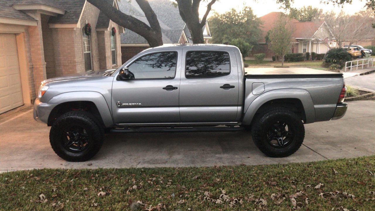

    3" ToyTec coilovers, JBA UCA's, Bilstein 5100's
    My 2015. 3”/2” 285/70/17 on 17x8.4 -10 wheels. Lift kit is from Toytec. CC09F4BF-3FC5-4C97-8D14-9E689DEC7B29.jpg
