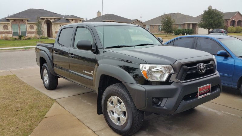

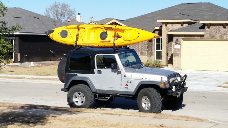

    I bought a used 2014 Tacoma Texas Edition with 14K miles in February.
    I came from the jeep world. My old ride was a lifted 04 Rubicon with 35" tires.
    The Tacoma, unlike the jeep is a daily driver. So my plan for the Tacoma was to keep it stock.

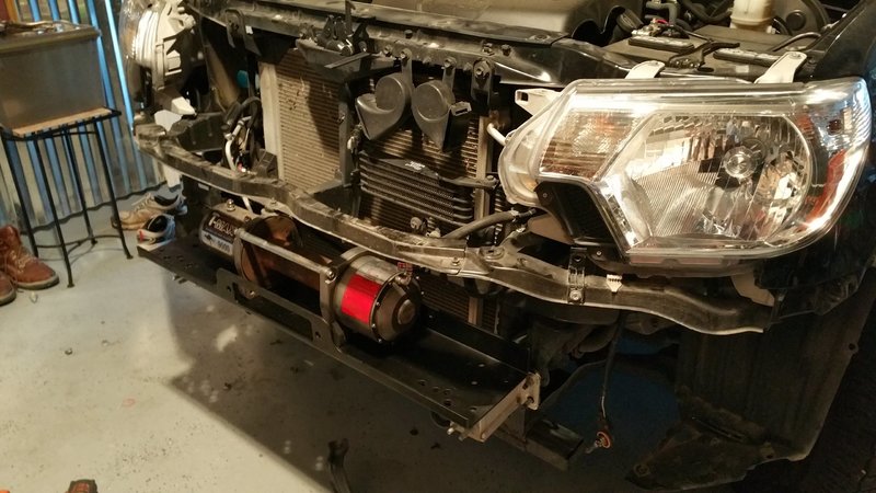

    Since I had my winch from the jeep I decided to make a bracket and install the winch on the Tacoma. Again, I researched this site and picked up a lot of great information.
    Mocking up to see how the winch plate would look like with the winch installed.
    I created the brackets from 1/4 inch steel plate with some 2x2 square tubing.
    Almost finished, I put the winch line in a later picture.

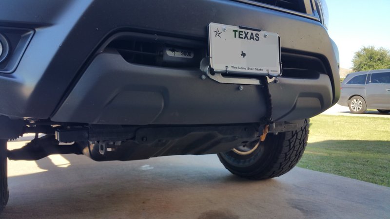

    Welcome. Love the hidden winch upgrade!

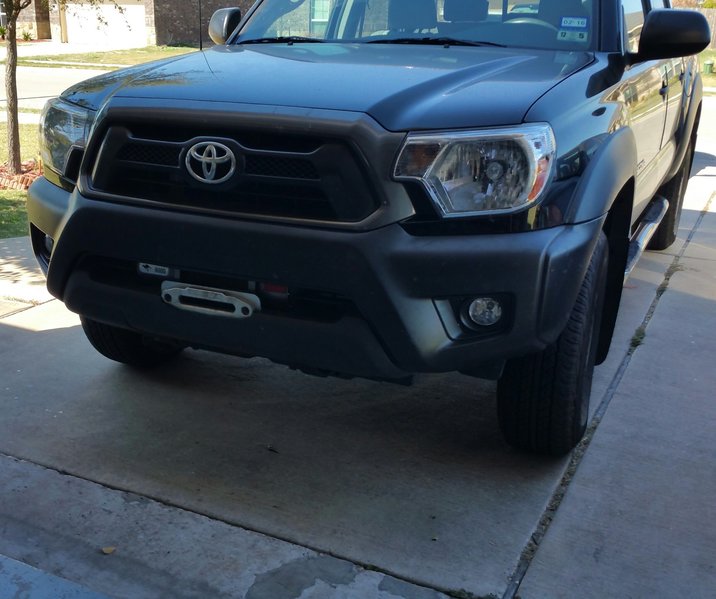

    Thanks for the warm welcome.
    The hidden winch was a lot easier to make than I thought. Here it is with the synthetic winch line installed. I remove the license plate to use the winch. The winch is a TMax 9000 lb. I did add some brackets to attach the hidden winch to the frame.

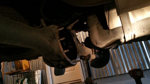

    Worked on removing the rear third:

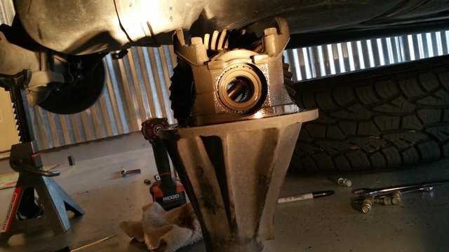

    Replaced with a different third:

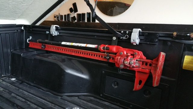

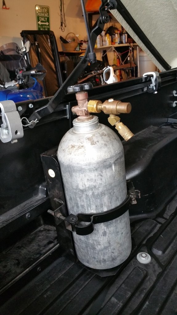

    Added some brackets to attach the c02 tank and the highlift to the bed tracks:
