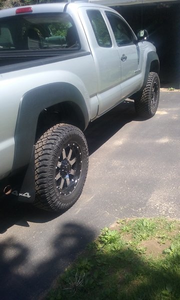

    I'm still trying to figure all this out I'm not sure if I'm doing it right yet

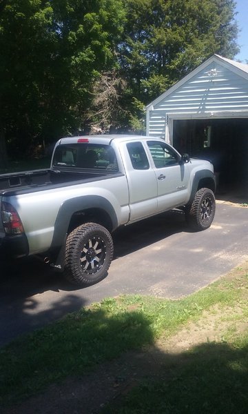

    Here's a few more i think

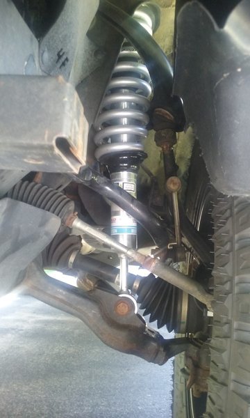

    That suspension angle does not look happy. Someone correct me if im wrong but those 5100 with eibachs should be on the lowest setting.

    depends on the spring rating, but I was thinking the same thing. It's still an nice looking rig you got there OP!

    Ya there from toytec and it said to assemble on second c clip setting but the passenger side coil spring does rub the uca other than that it's all good I had it aligned and it was all in spec

    It could just be the angle of the photo but it looks like the CV axle is at a steep angle. That's not usually a good thing because it needs the ability to have downward and upward travel and if its maxed out for downward it could cause problems. It could just be that it hasn't settled yet either especially if it were recently installed. Just keep an eye on it. Also some aftermarket UCA's will help if not eliminate the rubbing on the UCA.

    Looks like your coil seat is upside down.

    Holy shit, I think your right!

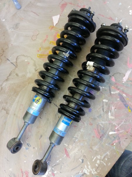

    OP, see how you can't see the black part on mine below the spring.
