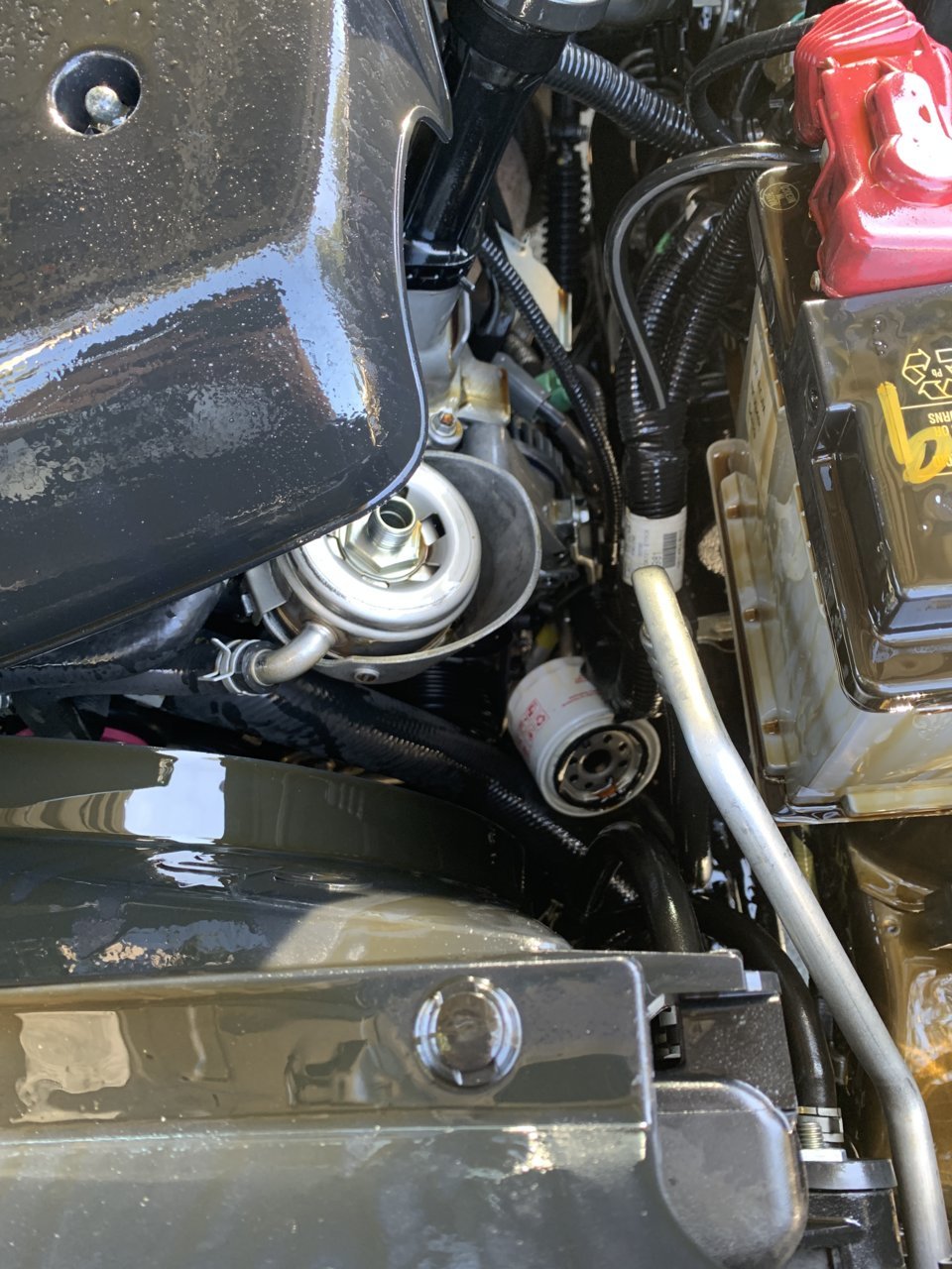

    Went to Carmax back in July to buy a Tacoma I found on their website. It was a 2013 prerunner TRD sport. I ended up buying the truck. About two weeks after I bought the truck, I was accelerating onto the freeway at the end of a pretty long on ramp. I was accelerating pretty quickly going about 60mph and gaining speed as I merged onto the freeway. All of a sudden I heard a pretty loud pop/small explosion sound under the hood immediately followed with a bunch of smoke and then about 5-10 seconds later a shitload of fluid sprayed all over the front of the truck including windshield. At this moment I kind of thought maybe a coolant hose blew off? Then I turned the windshield wipers on and it smeared what I thought was coolant all over my windshield. Luckily there was an off ramp super close that I could see. So I basically let off the throttle, didn’t turn the truck off though and coasted to the off ramp. As soon as I got off the freeway and started turning on the off ramp toward a normal street next to the freeway, the truck died. So I stopped, got out, popped the hood. Soon as I popped the hood I saw an oil filter just laying in the engine bay right under where it is suppose to be on the motor. Then I realized all the fluid that dumped all over my truck was oil. Then I realized that’s why the “coolant” which was actually oil smeared all over my windshield the way it did so I could barely see out of it.

    Did they say what they thought happened to make the oil filter pop off like that? From your description is sounds like it exploded off, or did it just fall off?
    Just curious I guess...they must have barely threaded it on if it fell off like that

    Not 100% sure, but from the picture it looks like the oil filter mounting stud is stripped. Oil filters are ment to be hand tight and then an additional 1/4 turn, people think they need to crank down with a filter/band wrench until they can't get it any tighter which does one of two things, pulls the threads out of the filter of strips the mounting stud. I have seen it happen 3 times and every time it has been after the vehical was serviced at a quick lube. But hey look at it as a short term lease or a extended test drive.

    Makes sense, I only ever hand tighten mine...never used a wrench on one. Haven't had any trouble with them breaking or getting loose.
