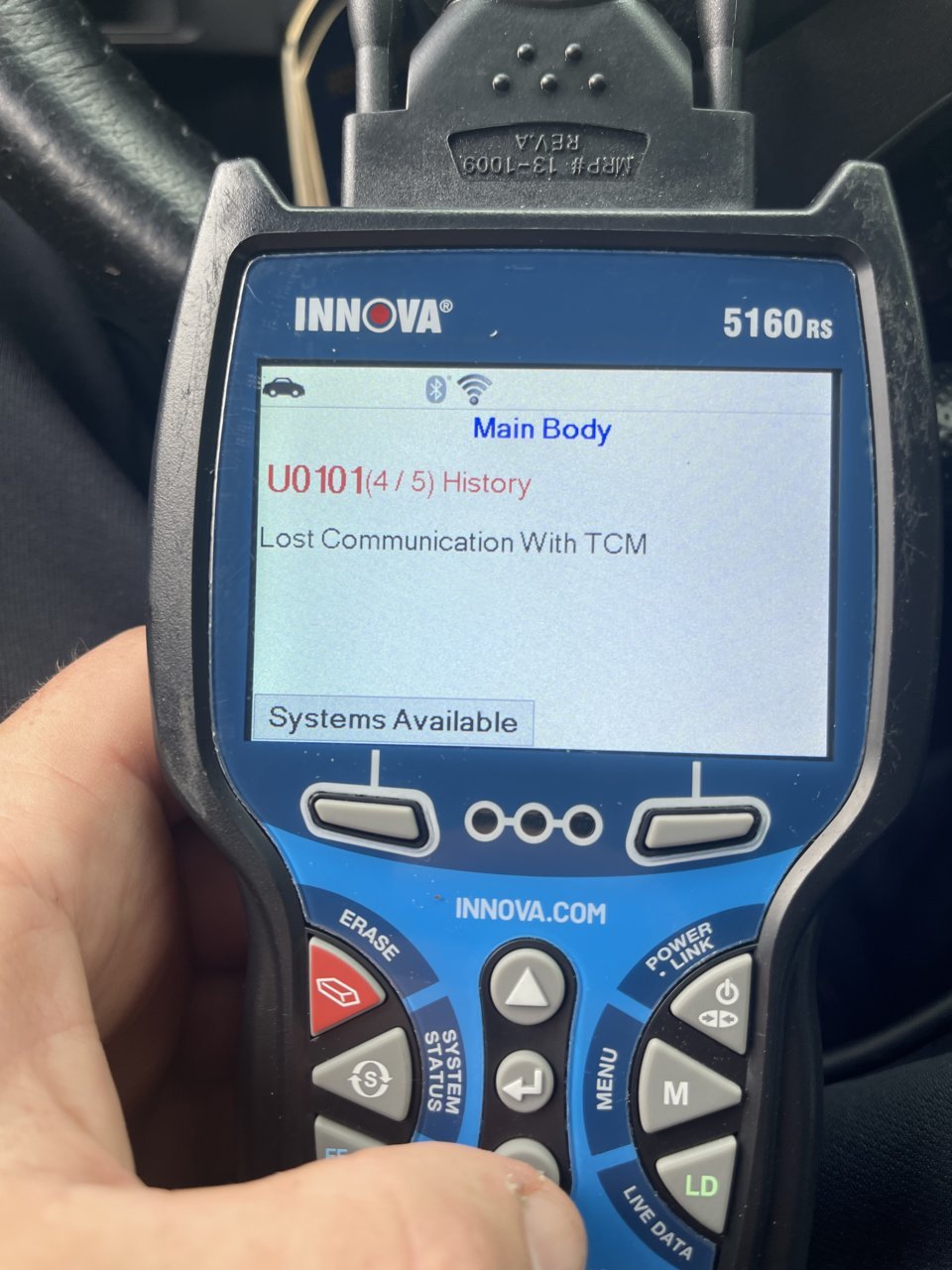

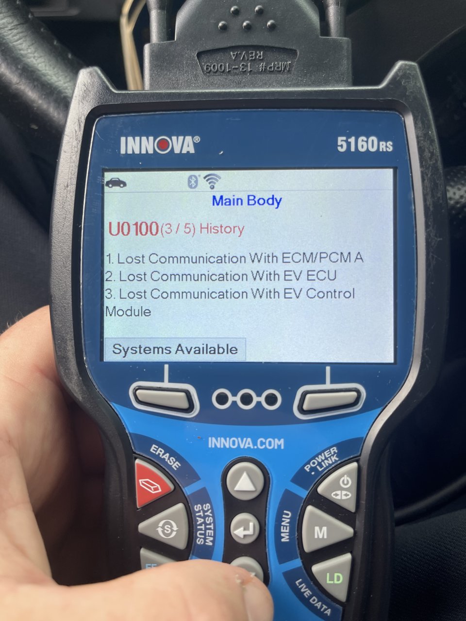

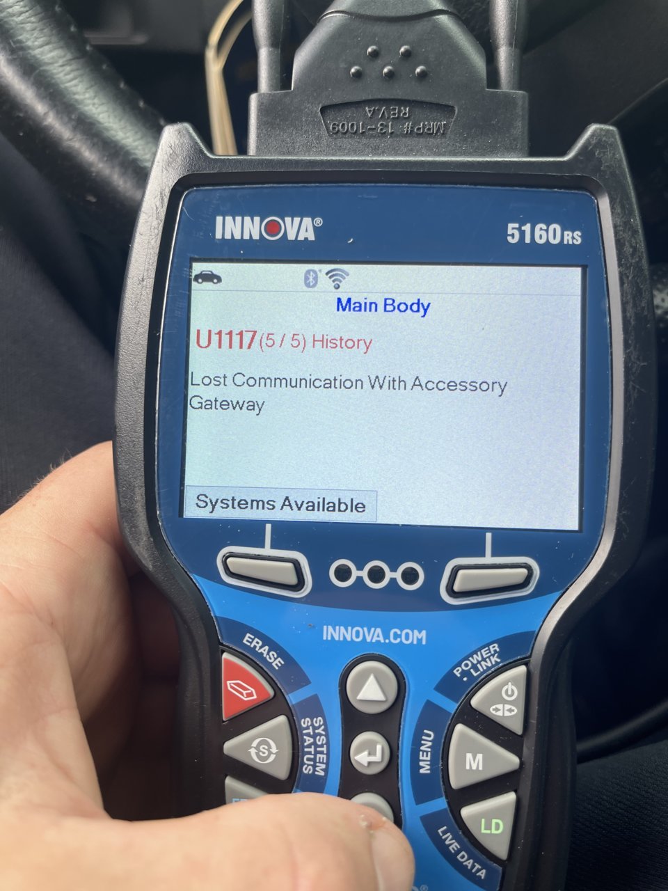

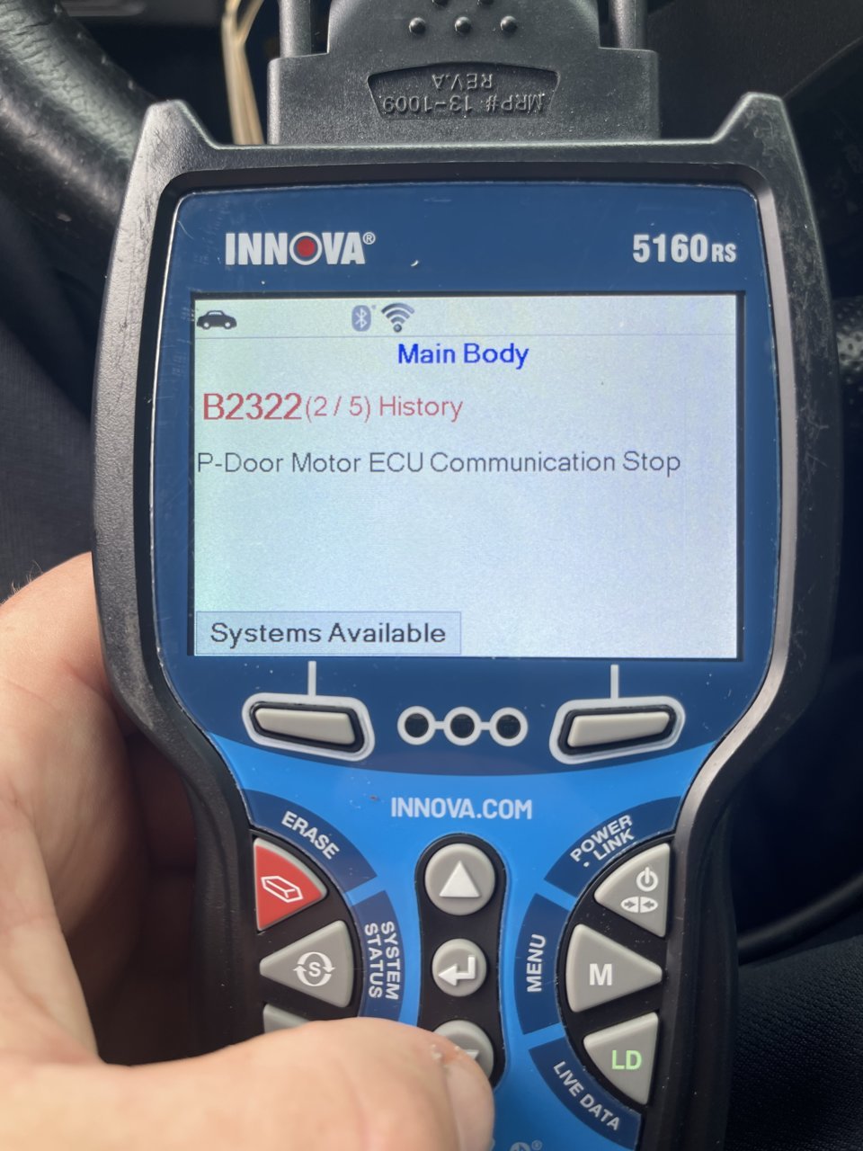

    Hi everyone. My name is Beau and I’m from Ct. Currently I own a 2016 LB Sport DBCab, 2012 LB DBC and a 2009 SB DBC. I’ve been following this forum for years with plenty of other Toyotas I’ve own but recently signed up because my 2016 is throwing a u1117,b2322, u0100, u0101, and u1117 without a CEL. Any advice would be greatly appreciated and thank you all for the warm welcomes.

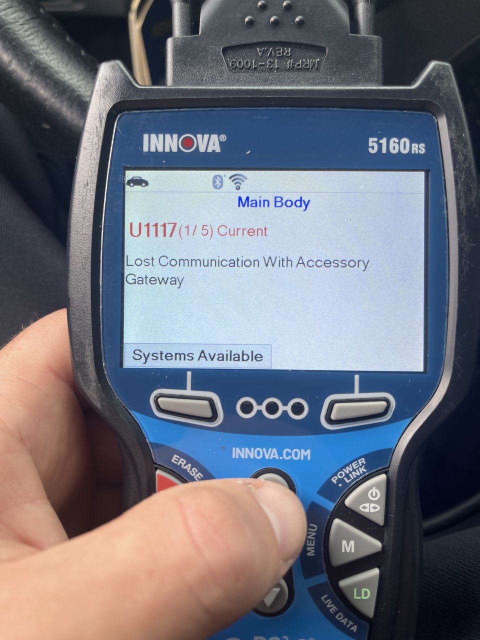

    I erased them all after I posted and u1117 comes back. Any ideas?

    How is your battery?
    Alot of newer vehicles will start setting communication codes when the battery starts getting weak, even though it still has enough power to start the engine the voltage drops so low that some modules go offline for just long enough to set codes.

    Might be exactly that. I threw a refurbished Interstate in it a year ago and I wouldn’t be surprised if it was on its way out. I’ll try a new one.
