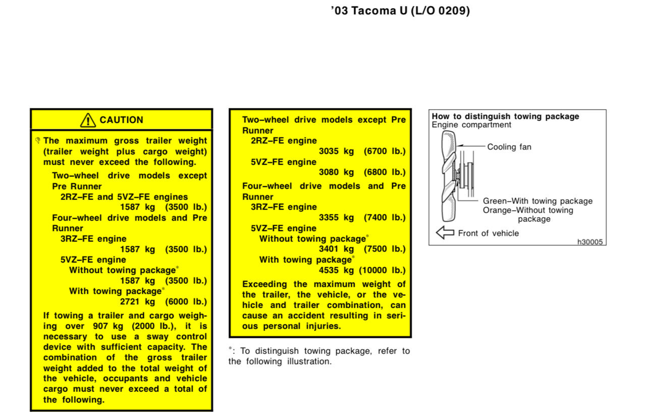

    The towing capacity is either 3,500 or 5,000 lbs.
    I believe you can do a VIN search on the Toyota website.
    All you have to do is register as a user.
    Then add your truck.
    Look directly behind your engine cooling fan.
    See what color the piece is that the fan is attached to.
    Green or Orange?
    Also, this is from a 2003 owners manual.
    davidstacoma likes this.

    This is great info and just what i was looking for thank you. My Transmission is a manual. do they have coolers for manuals?

    YES!!! Thank you so much for sharing this! I found this info in my manual a long time ago and i never checked my engine and forgot what color meant what.. Thank you SOO much! My truck does not have a tow package.

    My owners manual says if towing and cargo weight exceeds 2,000 i need to use a sway control devise.. I dont know what that is... anyone care to help?

    Follow your owners manual. If it says you need a sway bar then get one. A sway bar lessens sway, lean and roll in turns. It’s a safety device. I didn’t realize you had a manual tranny. You do not need nor do they make a tranny cooler for a manual transmission.
