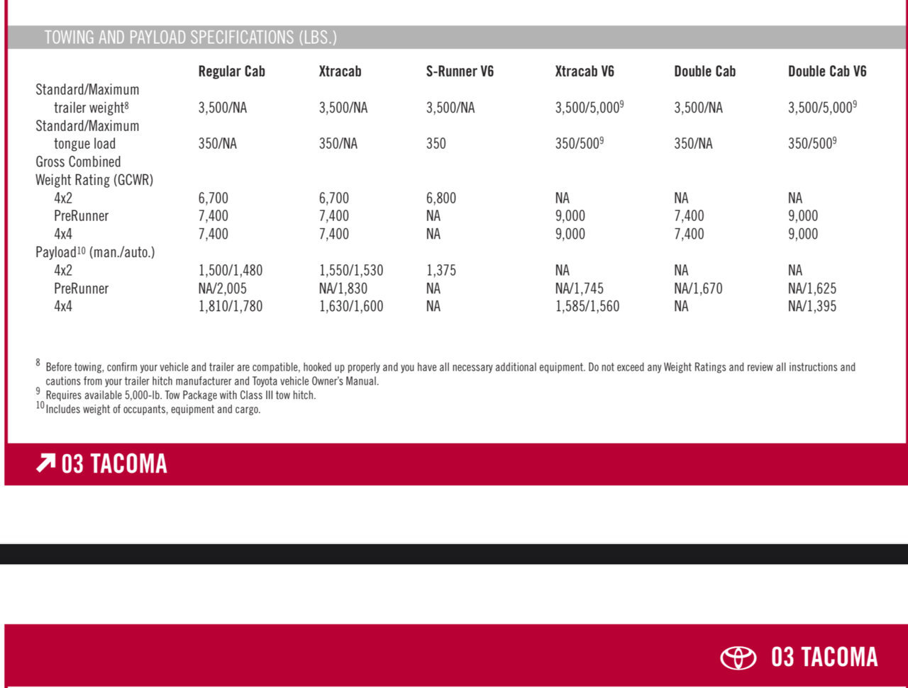

    I cant find my GCWR. My card on the driver door only shows GVWR and GAWR. I googled 2003 toyota tacoma GCWR and im still not seeing it..

    I found this in the 2003 brochure

  12. Jan 16, 2021 at 10:56 PM

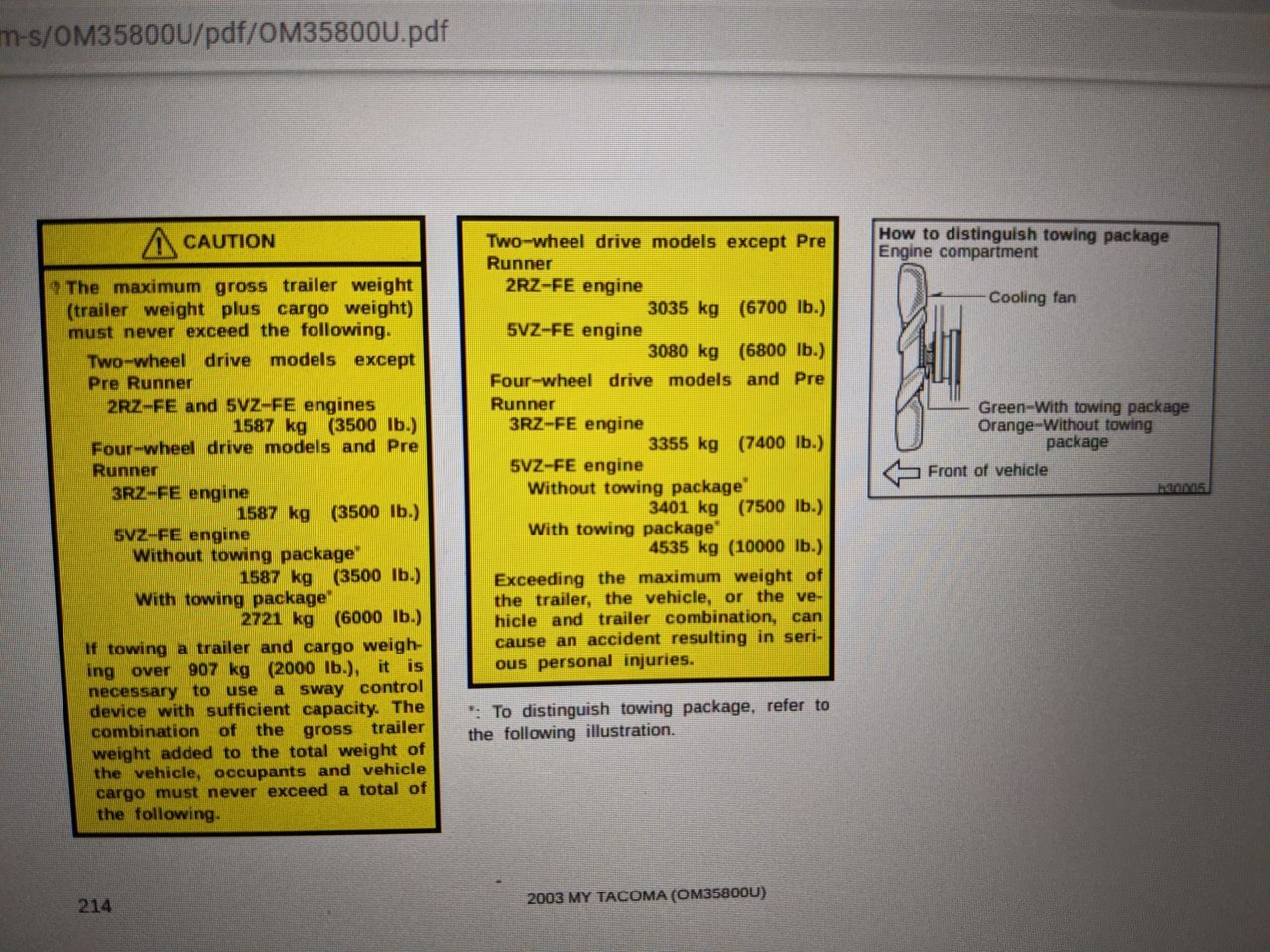

    I found this in my manual seems like its my GCWR but its different than the specs you found... so i think my weight is 7500??? My truck is v6 extended cab.

    Yes, your manual does indicate a lower weight.
    To be safe. You should follow the manual.
    Here is the brochure I got the information from.
    I have no idea why it differs from the manual.
    http://www.russauto.com/ncinv/modelinfo/brochures/03Tacoma.pdf
