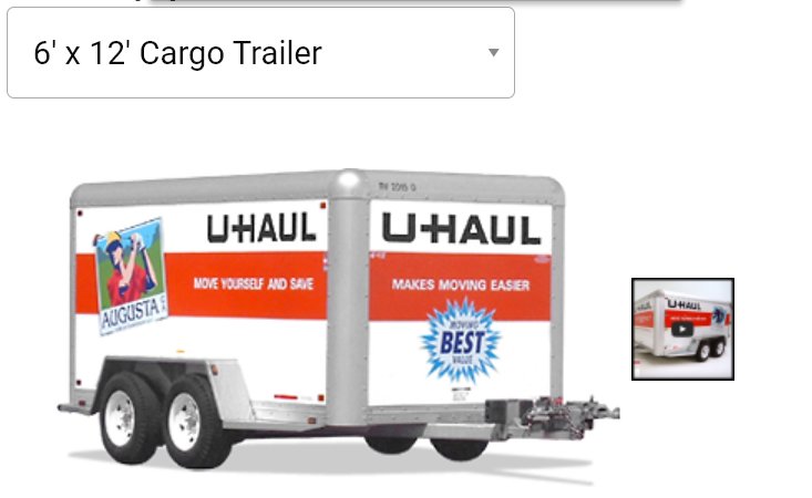

    You could always go rent one of these for a day and get a feel for what it is like to pull 2000lbs with your current truck or one you are contemplating. They weigh 2000lb empty.
    I pulled one loaded completely with my 06 Tacoma 4 cyl 5 speed manual and after that I knew that truck was not a good match for that amount of weight. The truck wasn't even capable of 60 mph on flat ground but that was with near 2800lbs total pull weight. The Tacoma was rated for 3500 lbs.
