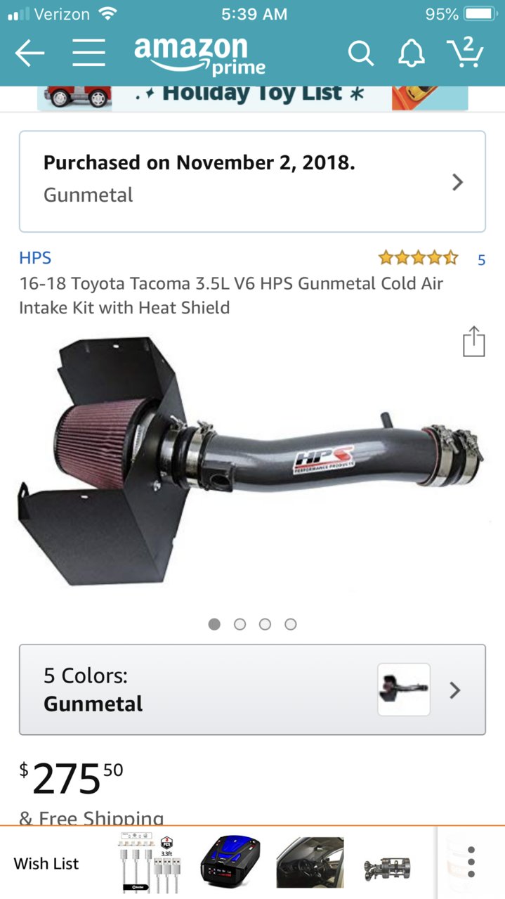

    good morning,
    So I recently purchased a 2018 tacoma sr brand new. I upgraded the air intake to the cold hps airtake. Everything was fine, but as I started up my car I noticed the CEL, occasionally the trac light will come on and off and my cruise control won’t even work/engage. Should I just put back the stock air intake? Is it cause engine damage? I’m going on a 3hr road trip north tomorrow and I really don’t want to damage my tacoma. I also don’t have a code reader on hand either
