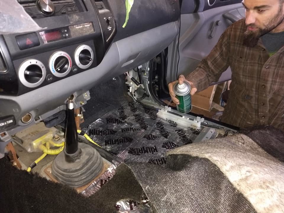

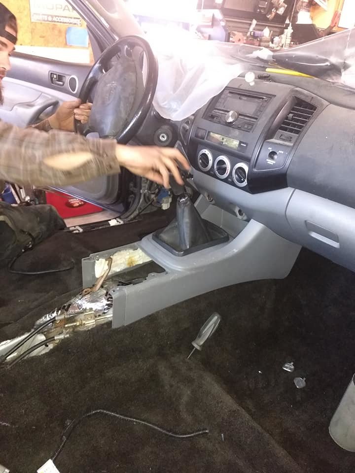

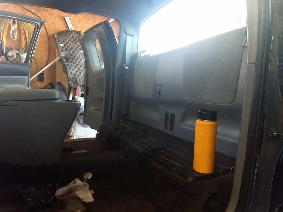

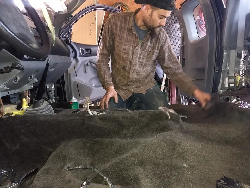

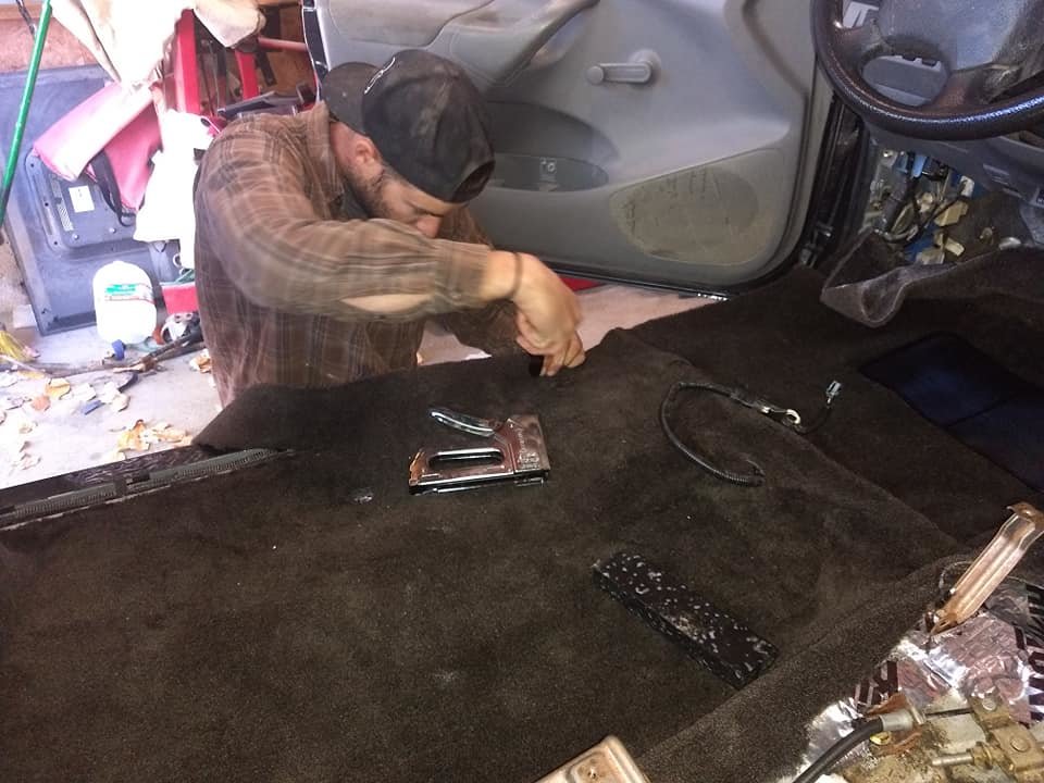

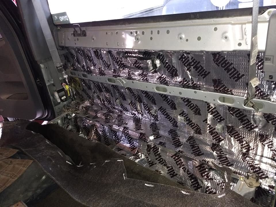

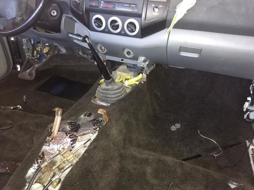

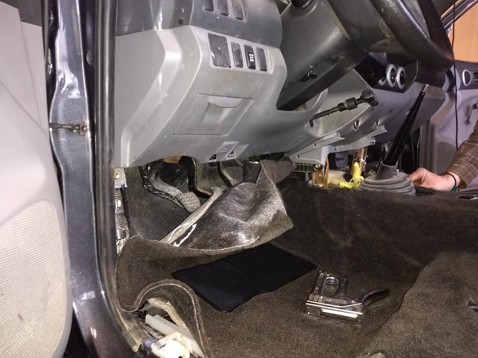

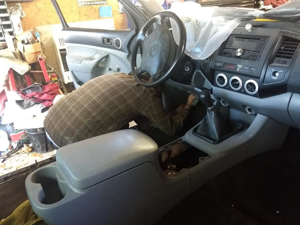

    Started the day at Grosswerx at 09:30 Chris and I installed Kilmat on the entire floor and back of cab.
    Next we installed the new carpet and the center console, then the rear cab panel and all the sill plates and lower kick panels...

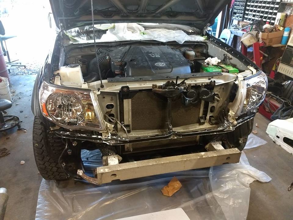

    Move up front, install spacers and trim tabs to lock the wings to the new front bumper, install rear driver's side fender flares up and cab 3rd brake light...mounted the front bumper w/fog lights new headlights and grille... Traced out wiring for fogs and installed new switch for them...end of day 7:00pm...
    Have not been able to assist as much as I would have liked .....but feel I made up a portion of that today...

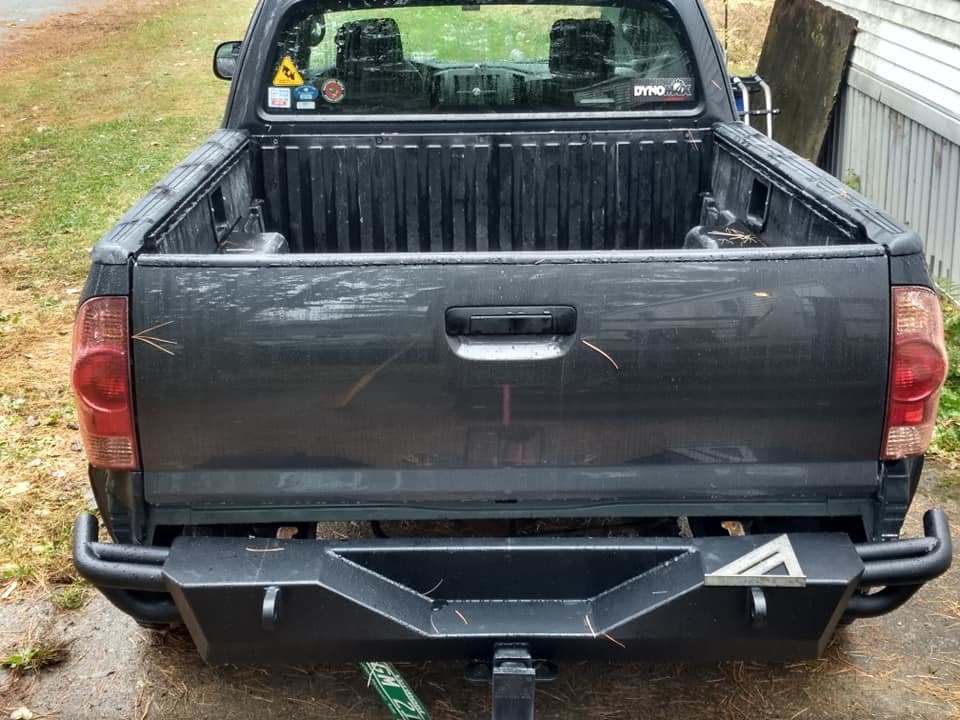

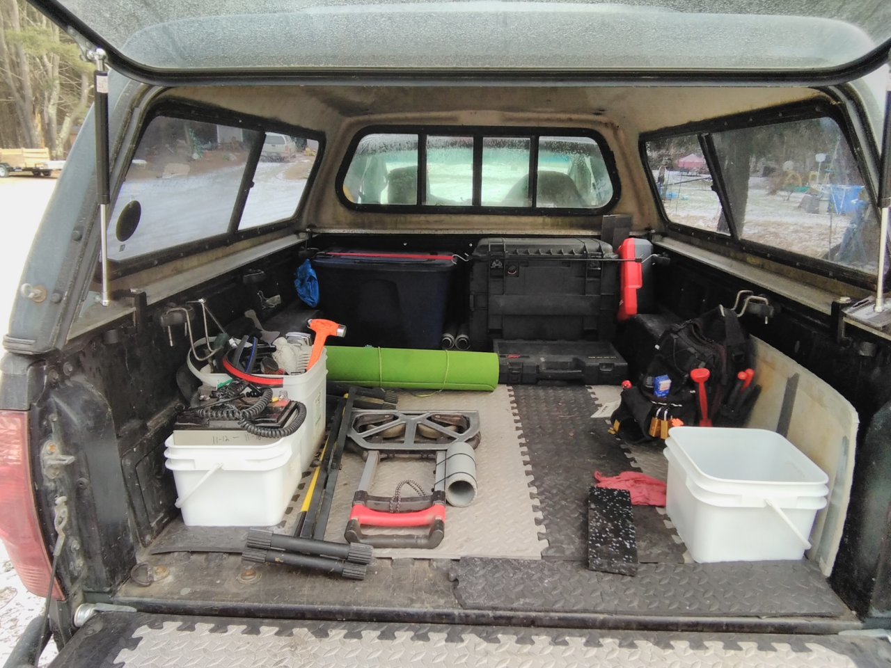

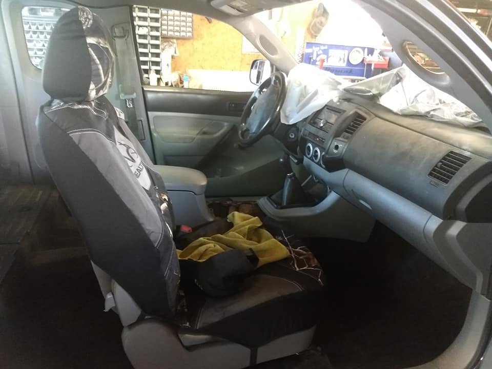

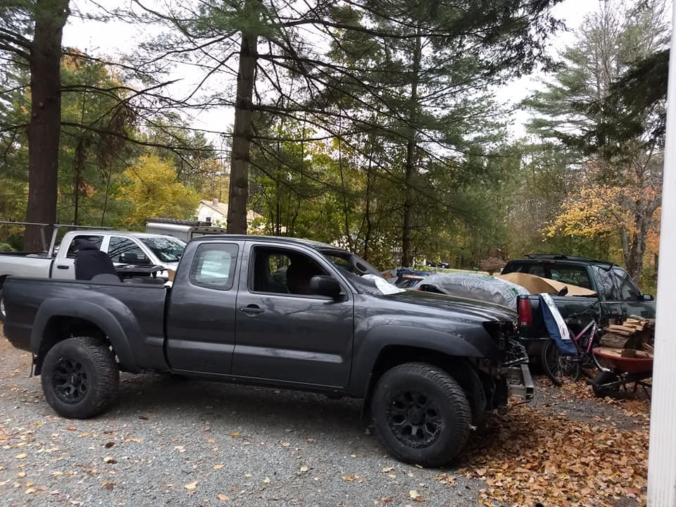

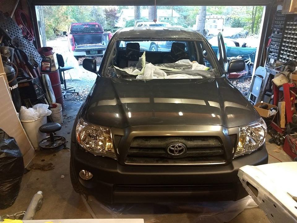

    some things to complete ...
    A) Rear bumper modifications and weld up the brackets for it....
    2) the spare tire holder is currently empty and i'm not sure if I'll put one back onder there ...
    Z) the Parking lights are not functioning so that gremlin needs to be fixed.

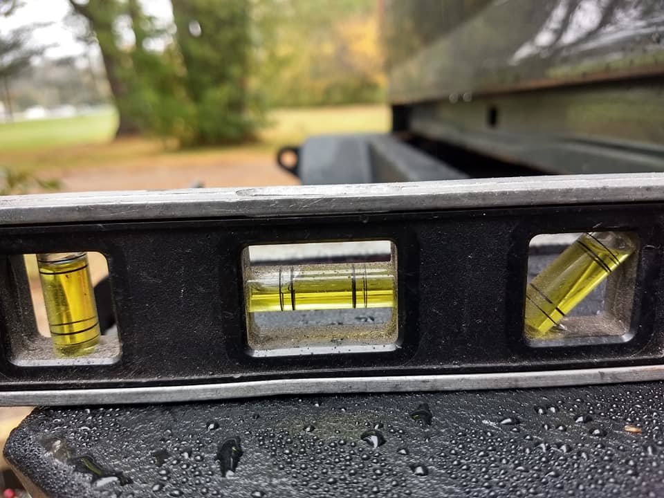

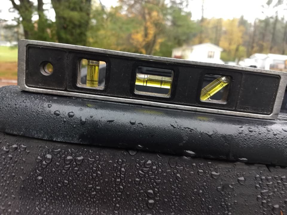

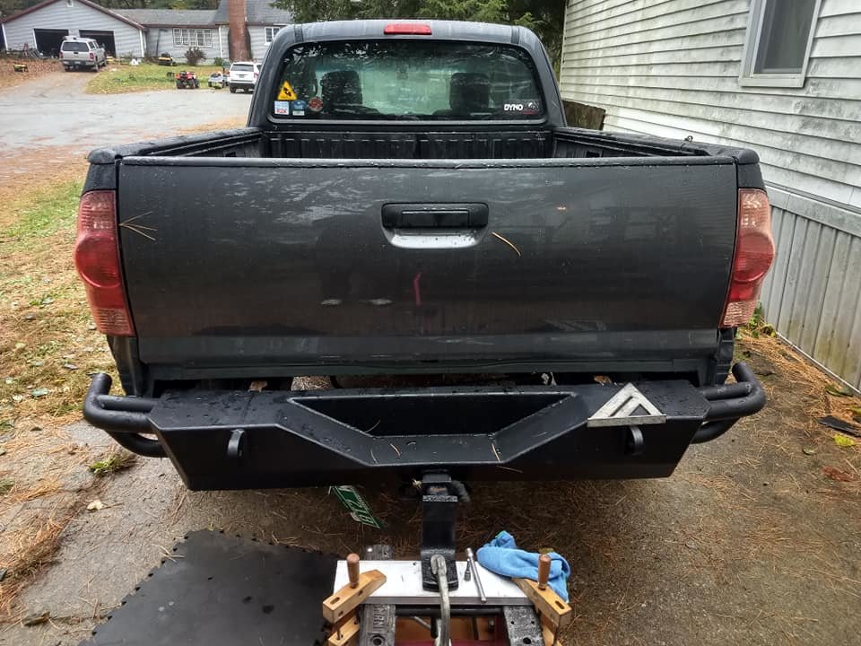

    Well I took advantage of the 34 minutes it wasn't rainin and pulled the ATV lift out of the shed.
    I then proceeded to attach a cross Beam of 2"X4" aluminum "C" channel and clamped the 6" drop Mount to that inverted.
    44982916_2336308576442249_38818703535589_5ccb1b4a2cac1f219b8ca9218c5471c3e3425f94.jpg
    At that point I mounted the bumper up to the Stand ......
    I then proceeded to " Square up " the bumper to the frame horns and surprisingly, it was about 3/32"
    to the right of the Center of the Box. Not enough for me to screw around with....Nope.
    44948326_2336308639775576_20341700755854_4cd084797ccdff120ba14740b06855ce86a2a516.jpg
    This leaves me with cutting and welding 2 2" X 2" X 1/4" Square tubes to weld the EAG supplied brackets to the OEM toyota brackets. I know from the photos that it looks like it is tipping away from the bed, I assure you I took into consideration that the truck was in fact NOT level ...lol
    44963458_2336308466442260_83732213655614_783cc9765491d442d8befdea9070f0c749b4a1e5.jpg
    45013153_2336308509775589_61136540090320_d61e0c8e20e144aa8a5f47165b77ceddc61b5773.jpg
    this will all be dealt with tomorrow on the lift and I will make it look correct because it will be...
    Also, Let me be the first to tell you all......I HATE PINE NEEDLES.........:sawzall:
