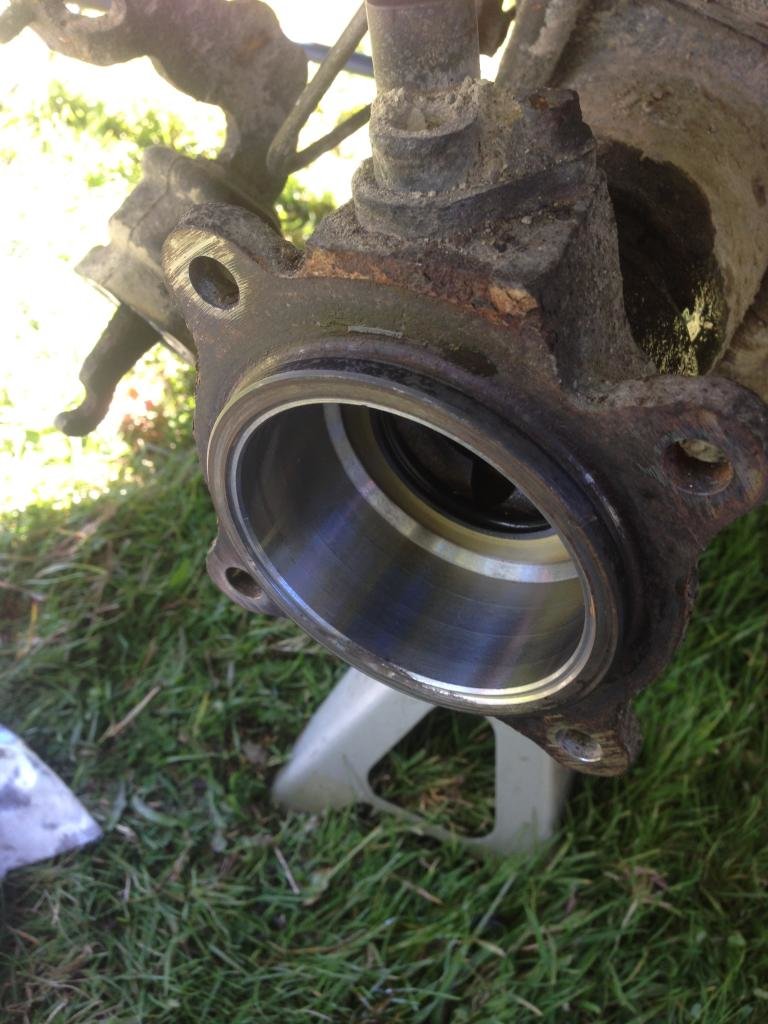

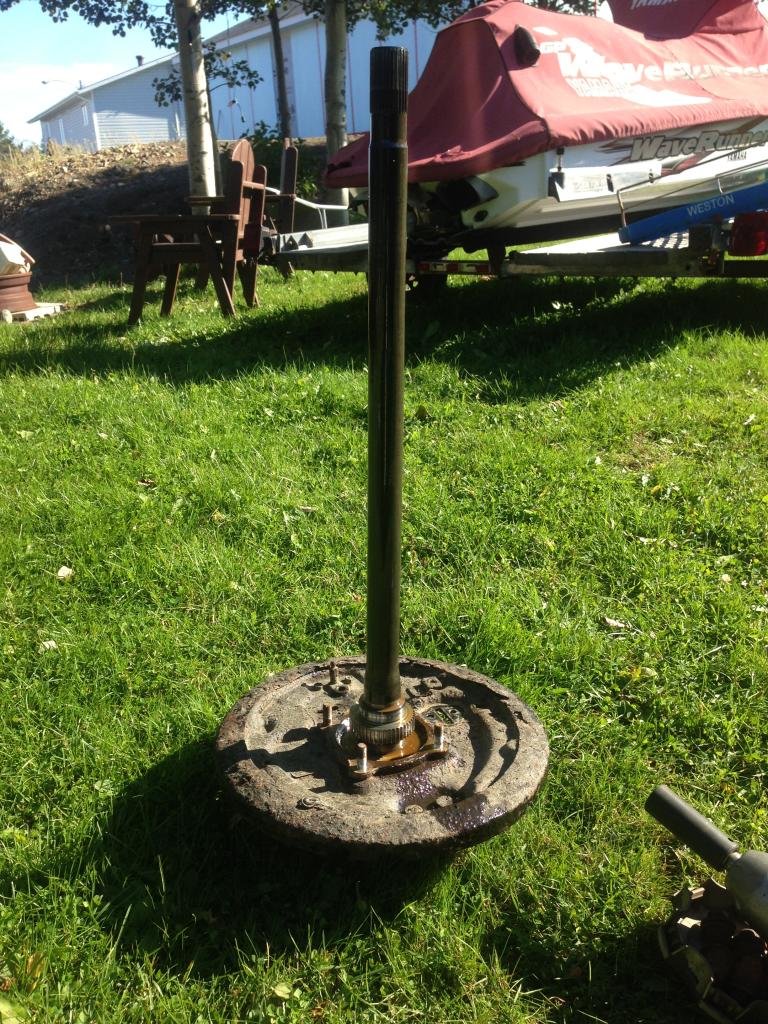

    The axle should come out with the removal of brake line/wire and 4 14mm bolts behind the drum. main oil seal is about 2" inside axle housing. The outside seal is just a dust seal that stays in drum/bearing assembly when removed.
