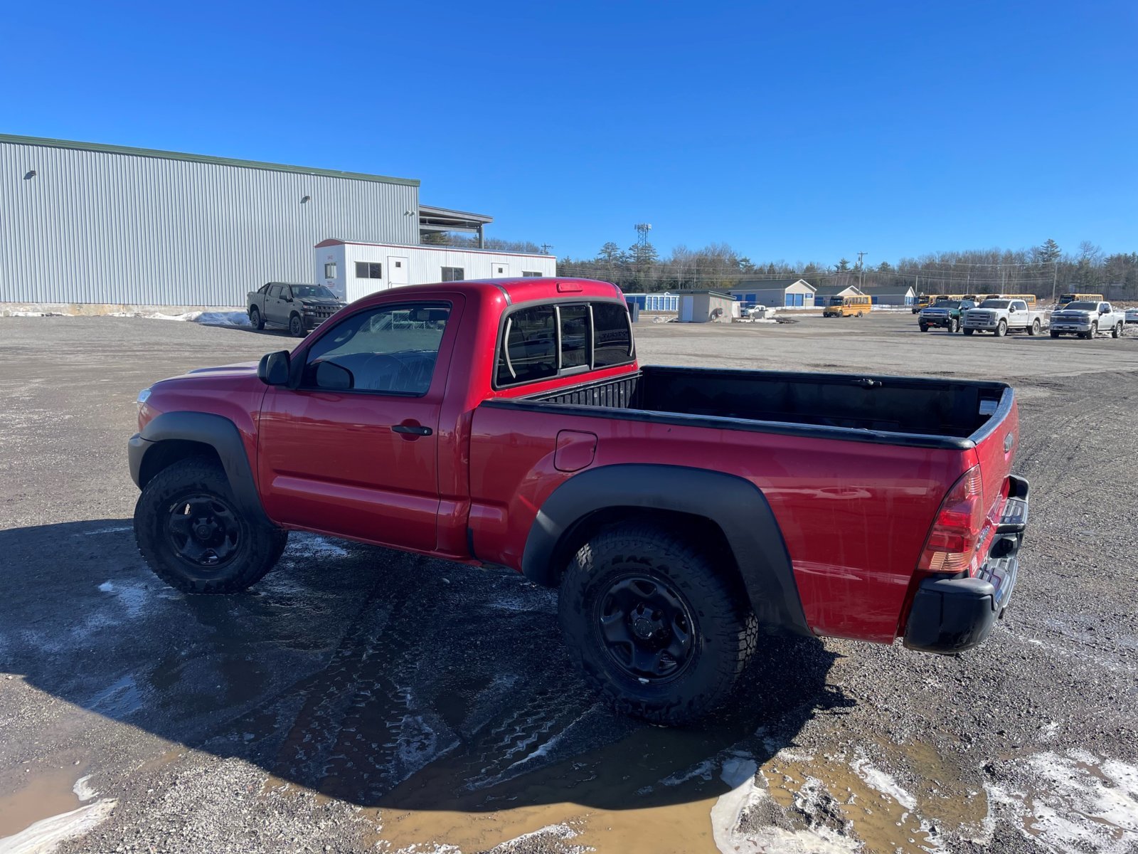

    Hi everyone, I have a 2013 regular cab 2.7L 4x4
    For years, i have taken the thing where ever i can get it hunting and fishing. I have been wanting to lift it and upgrade the suspension and think its time before this fall.
    I encounter mostly tight woods roads with sever wash boarding and the occasional washout/ruts requiring 4wd. I hardly do any off roading or 4x4 trails.
    I'm looking to get an additional 3-4" ground clearance for obstacles (and aesthetics) and want something that will increase handling and ride comfort when encountering deep pot holes and the wash boarding.
    Im not too mechanically minded and with my busy schedule would probably have something installed. I Don't have a set budget in mind just yet but would really appreciate some recommendations on what would fit my needs. Seems like there are so many options, im not sure what would work best for my situation.
    Thanks for any advice
    Happy to be here!
    captrussia253 and HondaGM like this.

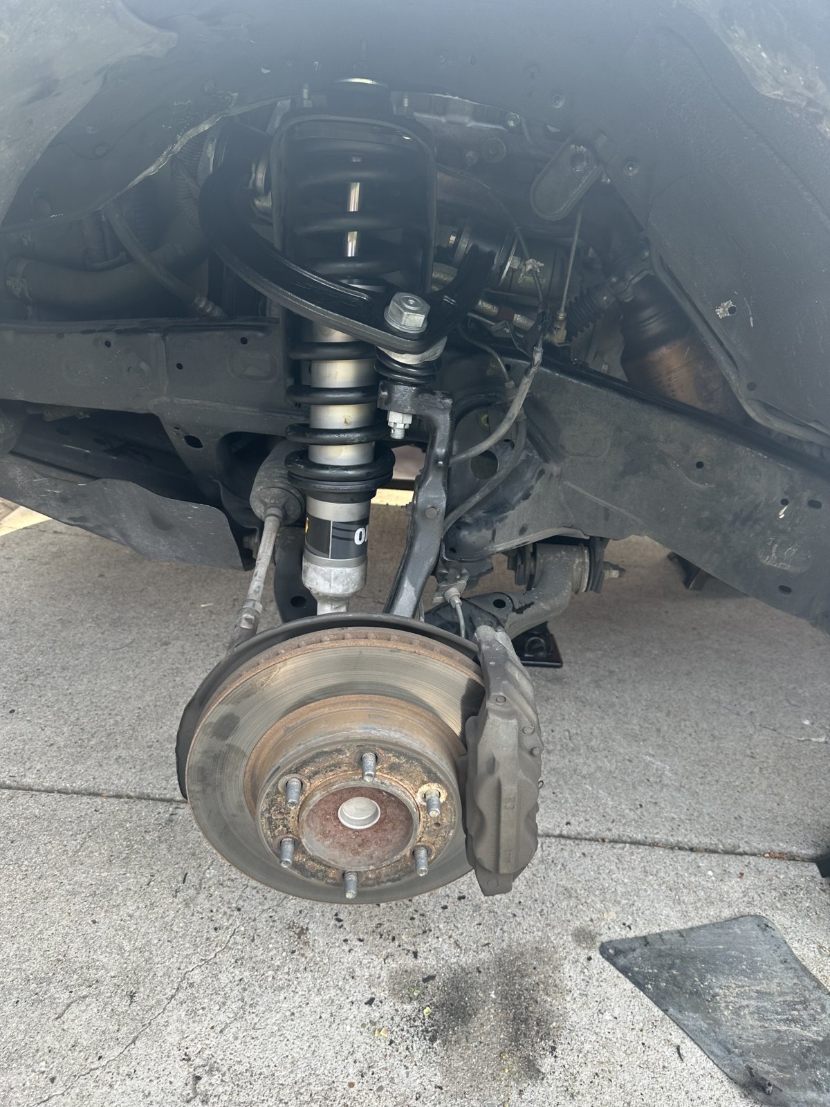

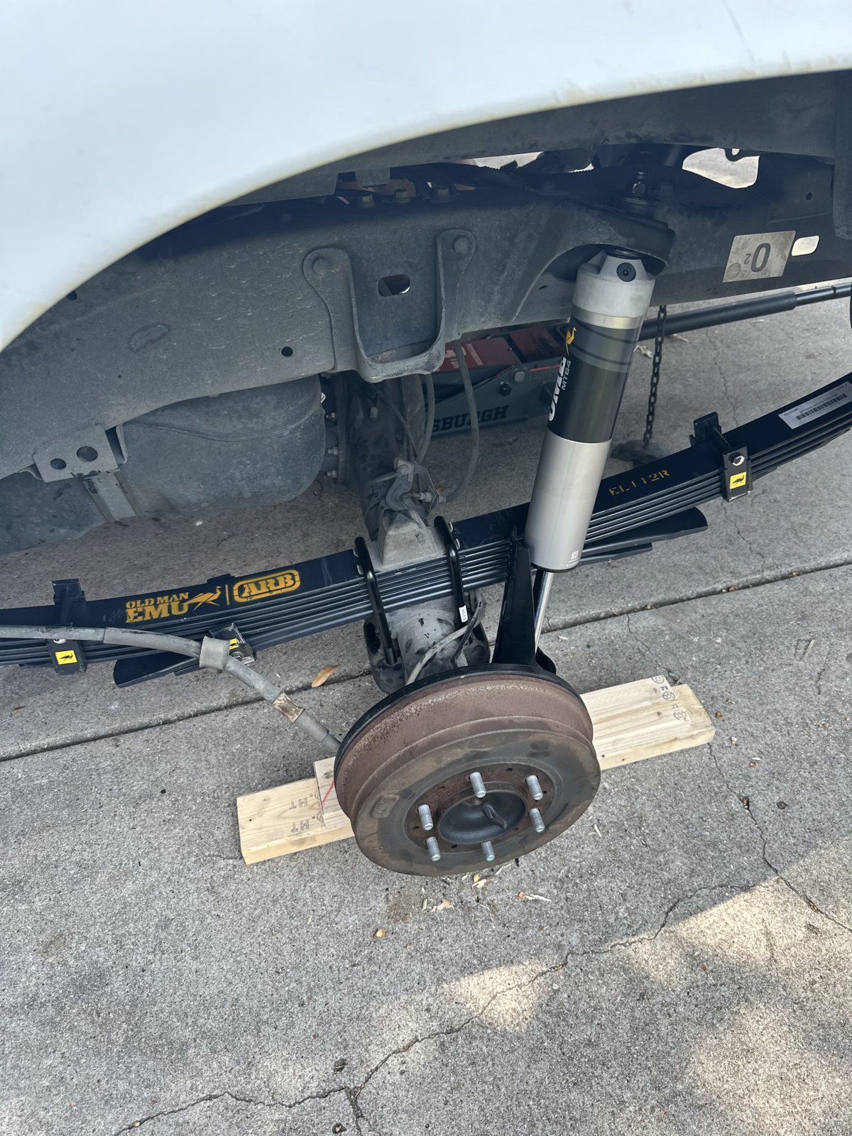

    I just did a swap to OME MT64s. They are comparable to the bilsteins, except a little beefier and rebuildable.
    My friend and I did it in the driveway in a weekend. Could probably have done it in a single day if it wasn’t 110 degrees outside.
    And for being mechanically adept… I did my first oil change myself last month. It’s easy. Lots of YouTube videos out there.

    forgot to mention I ended up with 3 inches in the front and 4 in the rear.

    Whoops, saw the photos posted of the suspension components and that was a 2WD truck. I thought those were from the OP
