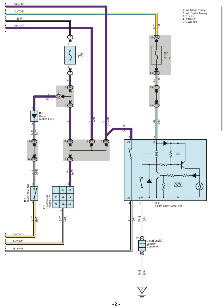

    All manual transmission tacomas (i assume) have a "Clutch Start Cancel" switch. Turn the key to ON, press the switch (indicator light should illuminate) and turn the key to START.... if that works then your clutch switch at the pedal is bad.
    Does the engine have any sort of oil leak that is hitting the starter. Thats the most common cause of starter failure I have seen. Gets all gunked up.

    Wow, mine doesn’t have that light, or button.

    I don’t think xrunners came with them. Easy enough to add though.
    Nana 4x4[OP] likes this.
  18. Apr 13, 2021 at 2:47 PM
    #18
    6 gearT444E
    6 gearT444E Certified Electron Pusher
    Feb 3, 2018
    #243372
    7,798
    Deep South
    Herculiner Hootus
    diagrams say only 4x4 models. It’s used for moving vehicle in low gear by using the starter motor, intended for use off road. All 3 of the black/yellow wires are in parallel and provide positive voltage to the start relay coil.
