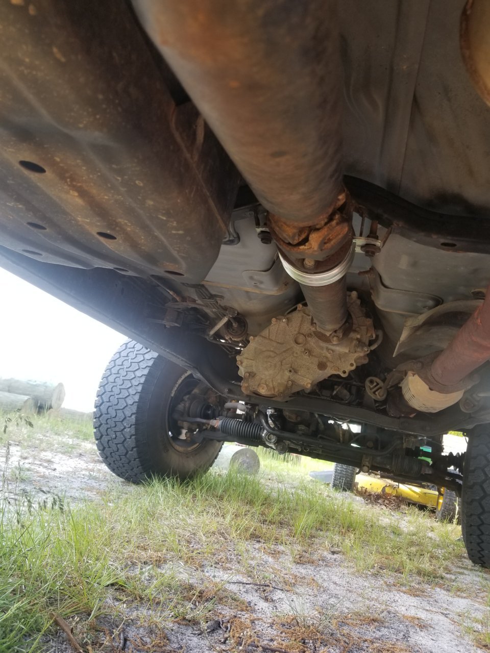

    2000 tacoma 4x4
    3 inch suspension lift
    So I guess it's a matter of process of elimination, gonna try the steel flat bar too as well I guess. The CV joint boots are shot as well I am gonna just replace both sides as well and see if that helps

    #175568
    30,285
    Josh
    Temple, TX
    6-speed death mobile
    CV boots won't change vibrations, but driveline angles will. Post up some pictures of your CV angles and driveshaft angles

    Have you gotten a drive shaft drop kit? Its a spacer and a bolt if I remember correctly. Same goes for the diff drop.

    Its called a differential drop kit. These drop kits tend to fix the vibrations caused by bad angles. Just make sure you get a steel kit. I cheaped out and got the $10 ebay ones (I mean its just a bolt and a spacer right? Why would I pay $30 for them if their combined worth is like $0.10?) and when they arrived they were plastic.
