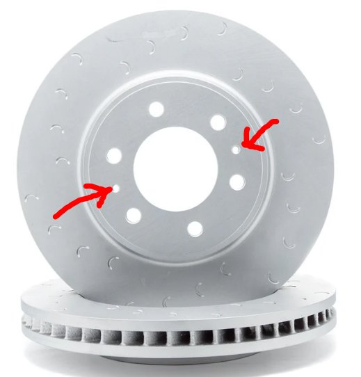

    The hardest part for me was trying to break the rotor loose, as it was rusted/corroded to the bearing assembly a bit. I ran to the hardware store and bought two bolts that thread into the holes on the rotor. These force the rotor off the assembly. This worked great, as a sledge wouldn't break them loose lol.
