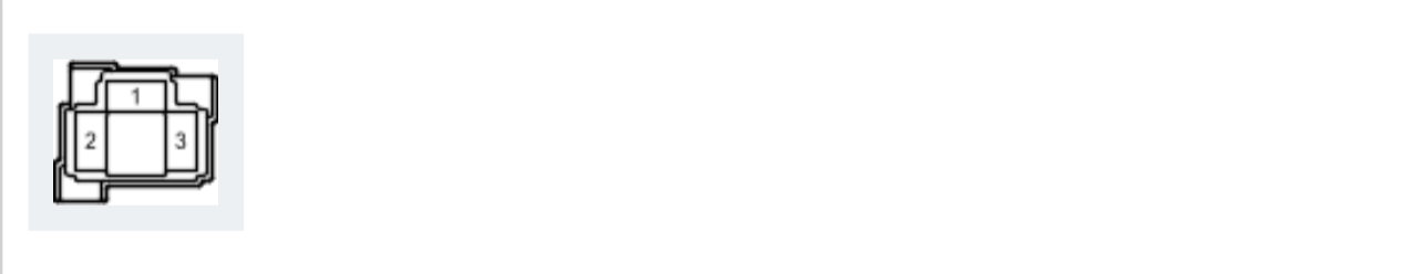

    1. low
    2. high
    3. Ground
  14. Jan 18, 2023 at 8:38 PM

    No.
    1. low
    2. high
    3. Ground

    Is #1 a white/black wire?
    Or is it Red/Yellow?
