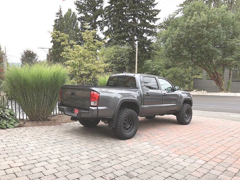

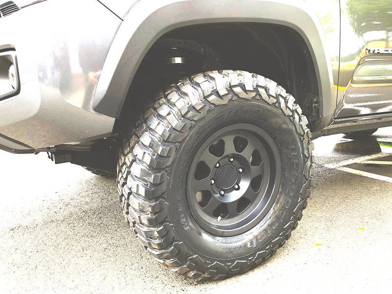

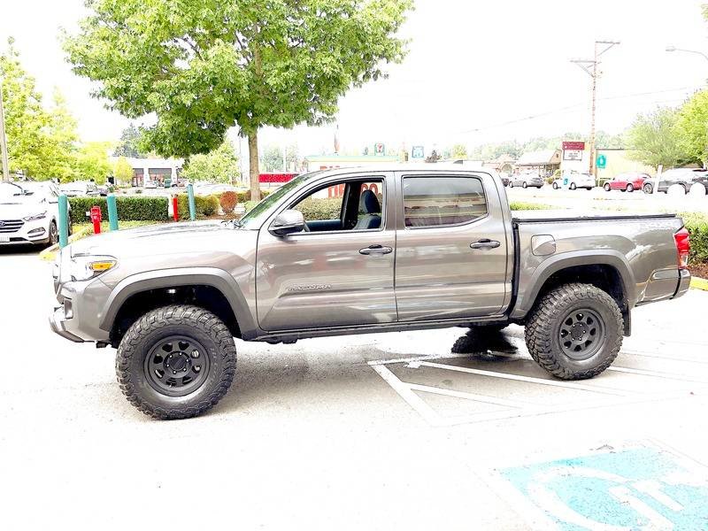

    #265621
    5
    New BFG TA KM3s 305/70/16 on method 16x8's
    banditcamp, TacoTim85, Bray and 13 others like this.
  5. Sep 9, 2018 at 5:45 PM
    #105
    Ctupton
    Ctupton Well-Known Member
    Jul 6, 2014
    #133410
    151
    What lift are you running? did you have to cut the cab brace? any rubbing?

    06wrb
    06wrb Member
    Aug 24, 2018
    #263902
    8
    East TN
    2018 Tacoma OR DCSB Quicksand
    Anybody else have pics of 16”? On a quicksand?
    @SurfTacoTruck looks great with 16” and upsize tires.
