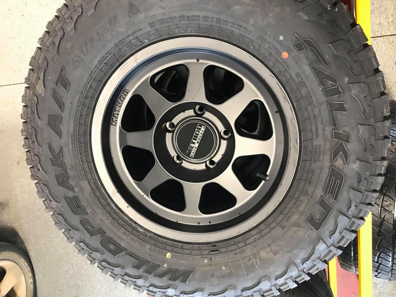

    So I got my rims in today, super excited.

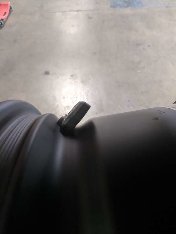

    Until I go to install the aftermarket TPMs I ordered, which are adjustable specifically so they can fit aftermarket rims, aaaaaaannnnnndddd they don't fit right. Suggestions @methodracewheelsalex ?

    Flip it the other way around for now maybe?

    Nah, it's even worse that way. Trust me I tried everything I could think of. The angle of the valves is just way more extreme on these wheels than the OEM ones.
    I'm just going to take them to my tire guy and see what he says,

    When I worked at America’s tire we strapped the tpms on the barrel just used a regular valve stem in its place.

    Well shit, I could just unscrew it from the stem and duct tape the fucker in place...

    Heat and centripetal force will quickly exceed the adhesive capacity of duct tape, rendering your hack ineffective. o_O:)

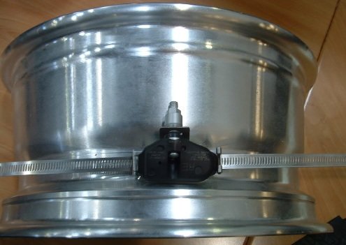

    Don't try epoxy either... probably will fail. Banded sensor seems like the most logical solution if you can't find a TPMS that will fit. Here's a TPMS mounted on a band bracket:
