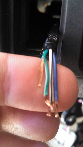

    could anyone tell me what wires go where for the otrattw switches?

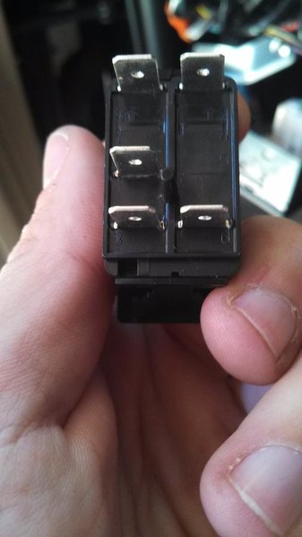

    I got this switch. I don't know a lot with wiring but I was trying to figure out what wire goes were or what the color wires mean. V1D1JCBB

    Not finding the CBB one but V1D1J should be like the ARBs.
    #2 is 12VDC source
    #3 is to the relay or power input of whatever you're turning on.
    #6 is tied to the dashlight circuit.
    Pins #7 & #8 should be grounded or to negative

    I just want to connect these wires to the back of this switch

    Do you have a voltmeter?
    If so, you can measure which wires have 12VDC with the ignition on then with the headlights on.
    The hot wire corresponding to ignition on should be Pin #2 (12VDC source)
    The hot wire corresponding to headlights on would connect to the dash light input, Pin #6
    Once you identify the ignition dependent wire, try contacting it to the other wires to see when the fogs turn on. The wire you touch when the fogs turn on go to Pin #3.
    The left over one should be ground and that ties to #7 and #8.
