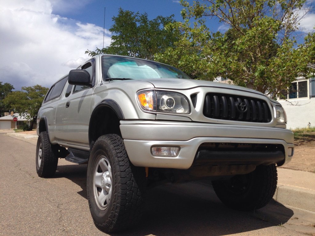

    Thanks again guys! Would not been able to do this without yall. Got an alignment today from firestone (that lifetime alignment though) they said I need new steering bushings - glad I got that lifetime!
    Pic because stance and awesomeness
