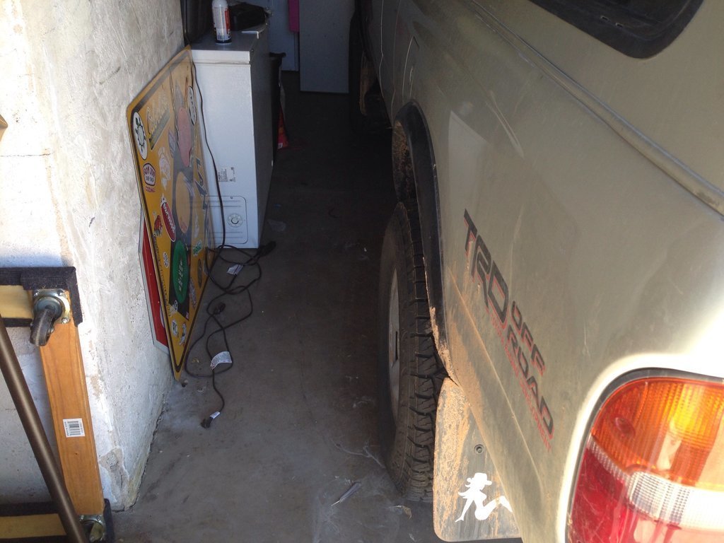

    Getting my parts in today so going to start this process this weekend. Barely squeezed my truck into the garage. There is only 32 inches between the drum and the wall though.. Damn damn damn looks like I will be working in the driveway. Hesitant about using it because it has just a bit of incline but since I am not taking both rear tires off just gotta chalk the shit out of the other 3 tires!

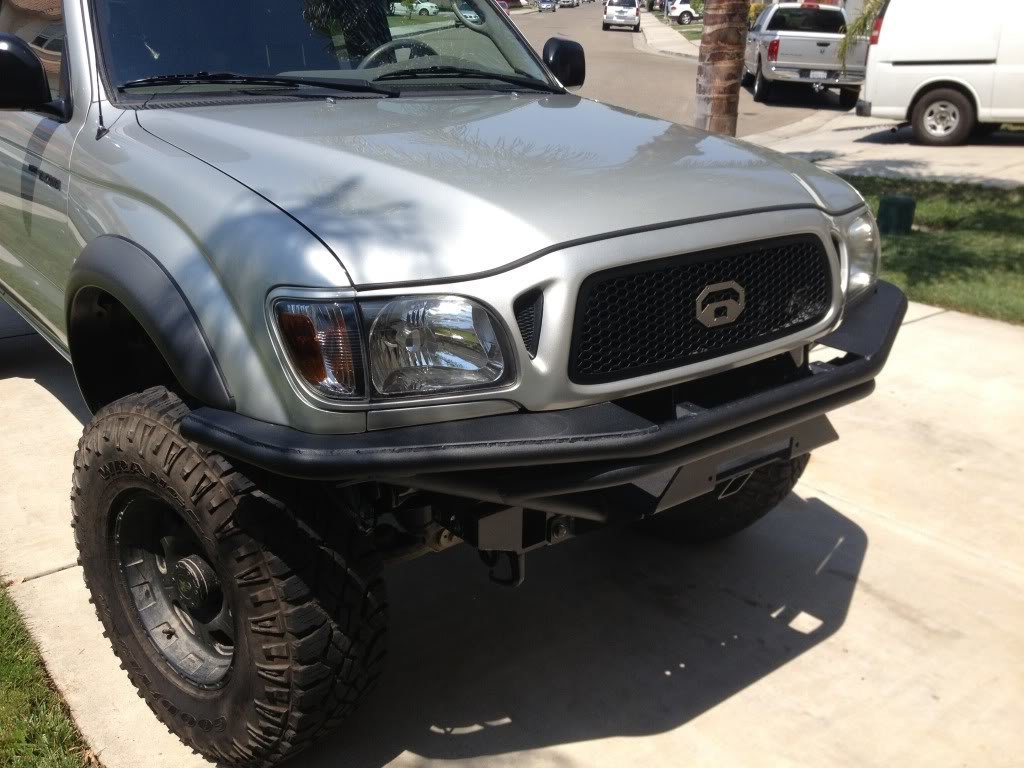

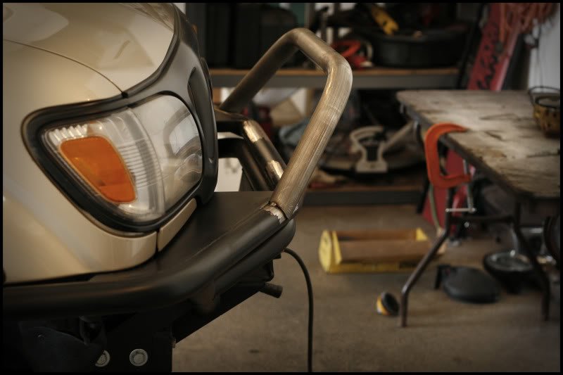

    My trail gear low profile tube bumper comes in tomorrow! Bought the weld on light bar so going to need that welded on. Also want to get some filler plates made and welded in as well. @Whitecloud could you fab these up and weld the light bar on like below?
    I guess like this too but not on top of the tubes
