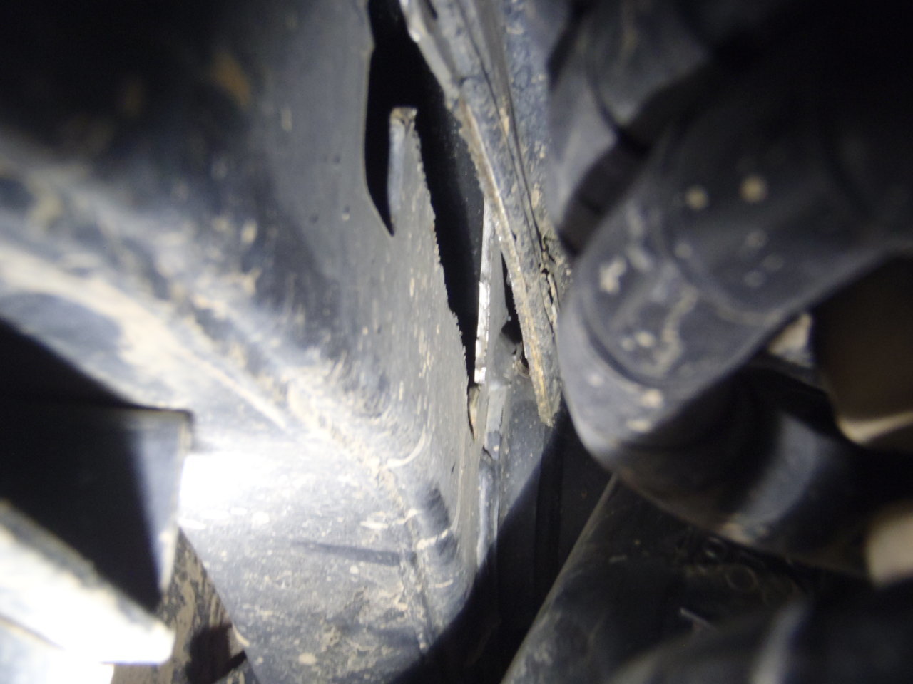

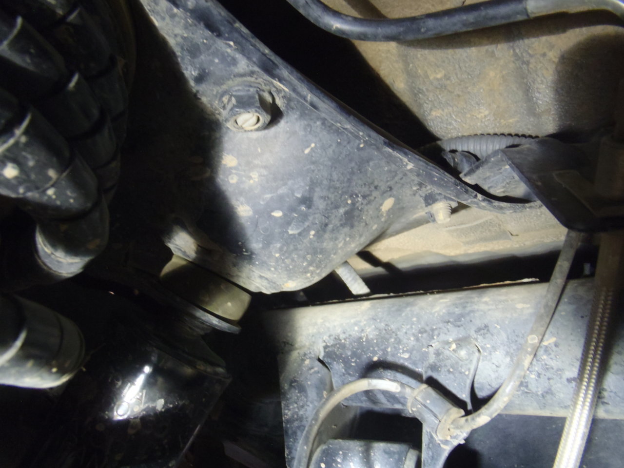

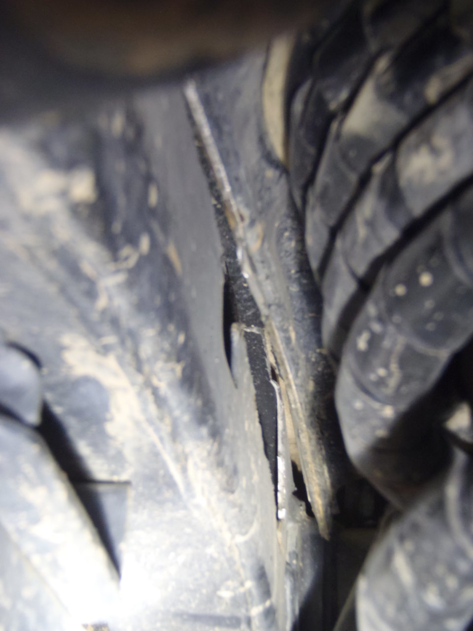

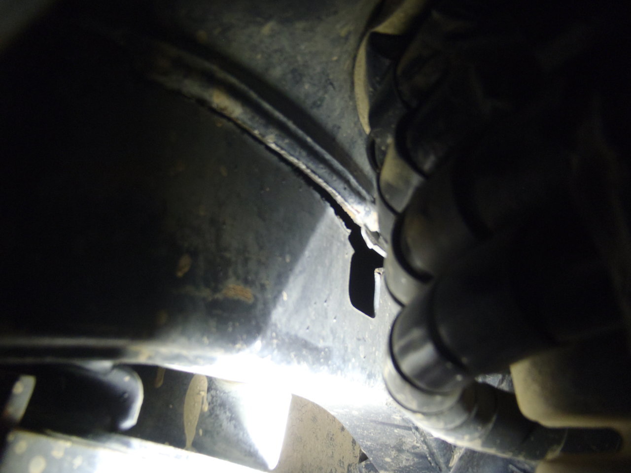

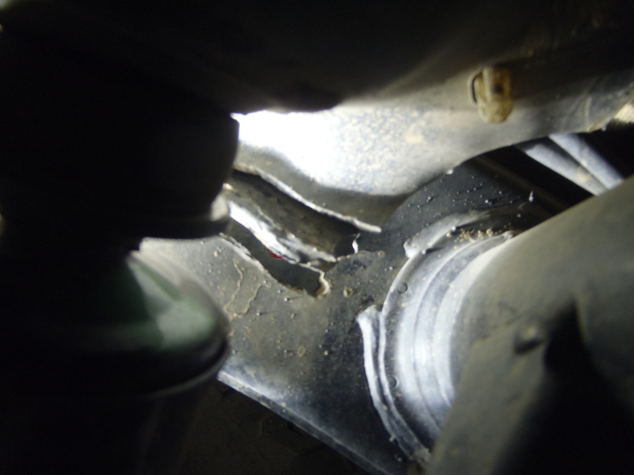

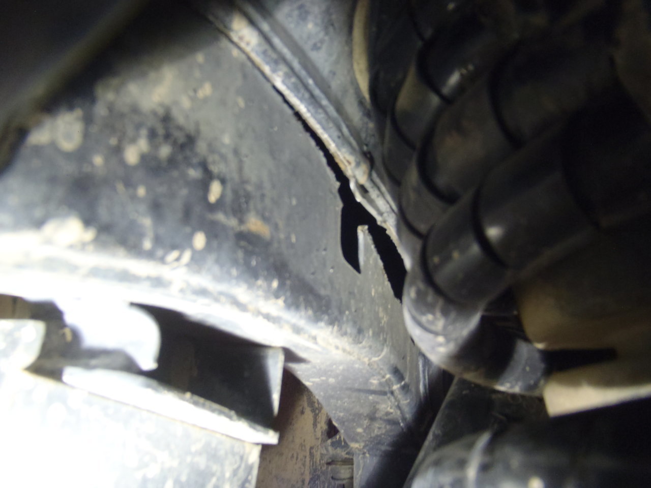

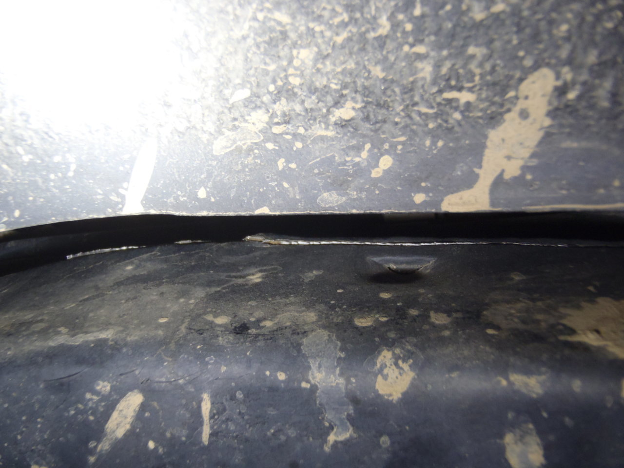

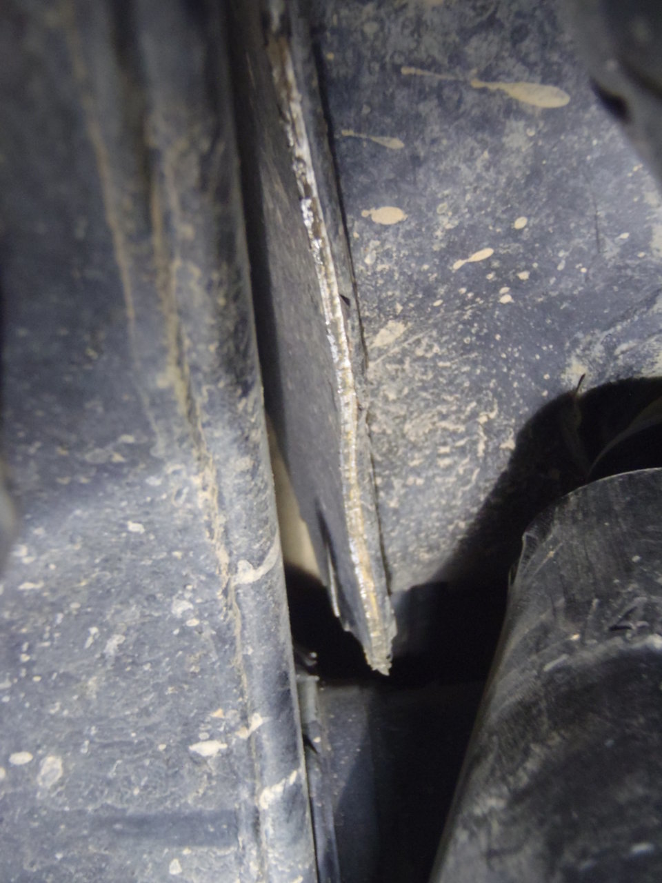

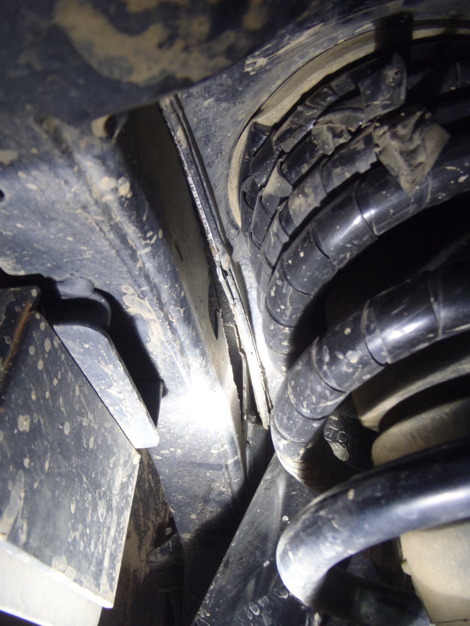

    Do not know if possible, but try removing the bumpers and armor reducing the load. Then drill a small hole at each end of the tear, this helps to stop the tear. From there is is going to be a process of welding the frame back together.
    Car Crafters and other body shops will not touch it due to liability. Then again I'd stay away from Car Crafters as they don't prep for body work from the start.
    Welder I'd trust lives in Las Lunas, but his schedule is booked for months.
    While a 3rd gen 4runner has a decent frame, it is not bullet proof. While your doing the job, I'd custom cut and weld in 1/8" steel reinforcements on the frame.
    With insurance it is a crap shoot. They might decide to total the vehicle stating frame damage.

    I don't see any value in removing the bumpers & armor. The frame essentially still has a full "C" channel intact, so plenty of support for the vehicle itself, and it's not bent. What needs to happen to execute the repair is the removal of the LR coil, shock, sway bar, and upper axle link. After that the area is perfectly accessible, and if necessary I could loosen the body mounts to gain more room. Then the decision will have to be made whether to cut out the old mount and weld in a new one (which is on order from Toyota), or try to repair the existing mount. I'm thinking it would be better to remove the old mount, work on the frame itself, then weld in a new mount.
    This is well within my abilities to self fix, but I'd prefer it done with a 220 machine and truthfully, I don't want to spend that much time in the garage.
    I want to avoid a regular body shop due to liability on their end, also... it's almost guaranteed they'll not only have it for a month (on the back burner), but that they'll screw it up at least once. I hope to find a fabricator and/or a shop that specializes in frame repair, not high volume fender bender fixes. After talking to my agent (like talking to a wall) she thinks the St. Farm approved shops can handle it... I'm doubtful. They opened a claim, but I won't follow through on it if there's not a decent outcome on the horizon.
    Nothing is bullet proof... this is what comes with the territory. I guarantee I use my rig harder than 95% of the population, and things happen.
