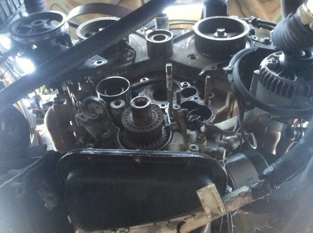

    what the hell is missing here lol
    be5268c4_cd6f697bc1b0b8bed970774e02ff4c6c2284a533.jpg did my water pump today i should have done it when i did the timeing belt a month ago... i can change it out in an hr now!!! whooo hoooo

    Nice, that job did suck the first time, I think I could knock it out in about 3 hours now. Using the snap on tool would make it even faster since you don't have to drop the AC compressor to get the tensioner off.

    they make a tool for that lol? wow lazy ass people lol it takes about 2 min to take off the compressor and the bracket so i dont need a tool lol

    yeah it's pretty stupid haha. They charge like 40 bucks for the stupid tool too.

    wow.... well i guess if you still use your A/C its a good investment but my ac is an air pump so i dont have to unhook the lines from it and i dont have to re charge it...

    Well you don't have to undo the lines, just drop it a few inches to get to that one bolt on the tensioner. Then you have to throw it in the vice and hold it compressed with a small pin. The snap on tool compresses it for you on the truck.

    i used a small allen wrench... to keep it compressed lol

    yeah same here

    so here this everyone with first gen's if you need a timeing belt or waterpump changed give one of us a call... and i wont charge you $650 like the dealer lol
