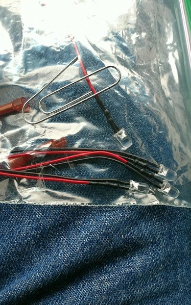

    So far since I have bought my 09 dbl cab TRD I have done the LED interior lights and the map light mod, the anytime fogs , the anytime locker switch mod and the cupholder led light mod. Coming soon will be the interior outlet mod with a snap in outlet and a hi lift carrier and ditch light brackets and lights from the hood hinge. VZM.IMG_20170125_172146.jpg

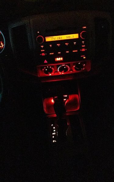

    How did you do the cup holder light mod?

    I took out the cup holder and the shifter console and then drilled holes in each cupholder. Inserted and hot glued the diode in each hole. Then I took out the shift indicator light and soldered in the wires from the diodes to the connectors under the plug where the bulb is in and it is very easy. Probably took a half hour start to finish.VZM.IMG_20170126_151827.jpg
