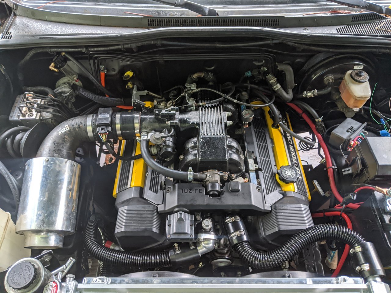

    Do a 1uz or 2uz swap like I am

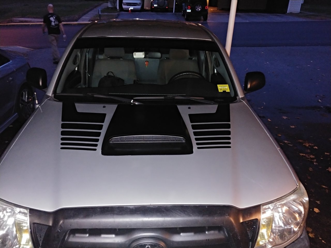

    In the meantime, I dumped a whole bottle of engine restore in the oil and she's picked up some missing pep. My ass dyno says the trucks taking off faster and has less trouble up hills. Seems to not have the slight hesitation it used to switching from 2nd to 3rd.
    I'm going to be doing a compression test tomorrow and see if it brought my numbers any. And it doesn't seem to be consuming nearly as much oil now. But that could be just from only driving 8 miles a day vs 100.
    Anyway, here's a pic of my new added horsepower
