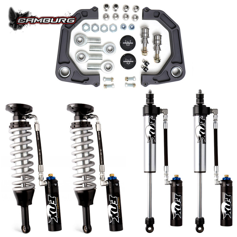

    hello.. im new here.. and new to the off road scene..also just got a 23 tacoma of road and am getting it lifted on fox 2.5 dsc all around with camburg UCA next weekend..

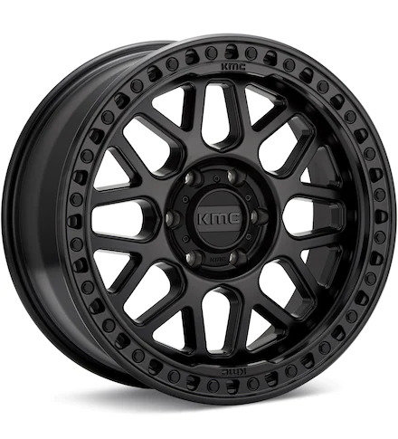

    im getting 17x9 with -12 offset and im doing a cab mount chop.. would that be an issue?

    not necessarily, 0 to -12 offset is pretty common

    ya..but the 17x9.. compared to 17x8.5.. the wheel i want doesnt come in 17x8.5.. or if it does..they dont have it in stock

    Those are heavy wheels; which tires? I like those billet camburg's, but have heard of a handful of instances where the uca hits the shock near the uniball due to the 1.25" size.

    They claim it’s 37 lb each. And claim it’s “lightweight”
    i hope I have no issues.

    And it won’t be the billet one. It will the tubular uca The pic just shows the billet one

    the shop recommended me not to. Not sure why. The truck has 2k miles and they said I woudlnt have that issue as long as I don’t exceed the 3inch. But I think the fox only gives about 2.5
    Also. He said he can add a leaf. Or sell me a OME leaf pack. Any suggestions?

    It's just a inherent design flaw with the needle bearings in the tacoma they have so much play even straight off the lot that they don't jive with lifts. I noticed a major difference when I did mine.
    The 2.5 will do 3" of lift.
    As for add a leaf vs full leaf pack that comes down to intented use.
    You might be best off here to outline intended use of the truck to better suggest parts across the board.
    To chine in on wheels if I read that right your wheels are coming in at 37lbs which is incredibly heavy on these trucks. I had a 30lb wheel and recently dropped to one at 20lbs but added an extra 10lbs of tire and the truck drives virtually the same.
    Rotational mass/unsprung weight is a huge component to how the truck will perform and how badly it will bankrupt you on fuel cost
