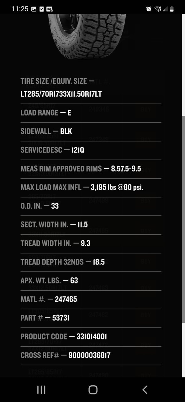

    im going with baja boss AT 285/70/17 which is 44 pounds and the wheel is the kmc grs at 37 pounds.. is that extreme?

    I mean the baja boss at 285/70/17 online said it’s 44. I may be wrong. Someone in here mentioned it’s actually 64

    They do I ran that set up for a year. You may tap the mud flap on occasion if you bump up the wheel offset but that's all. Stock wheels with that 265/70 no issues.
    As for that baja boss tire weight. This is it pulled for the mickey Thompson site at 63lbs

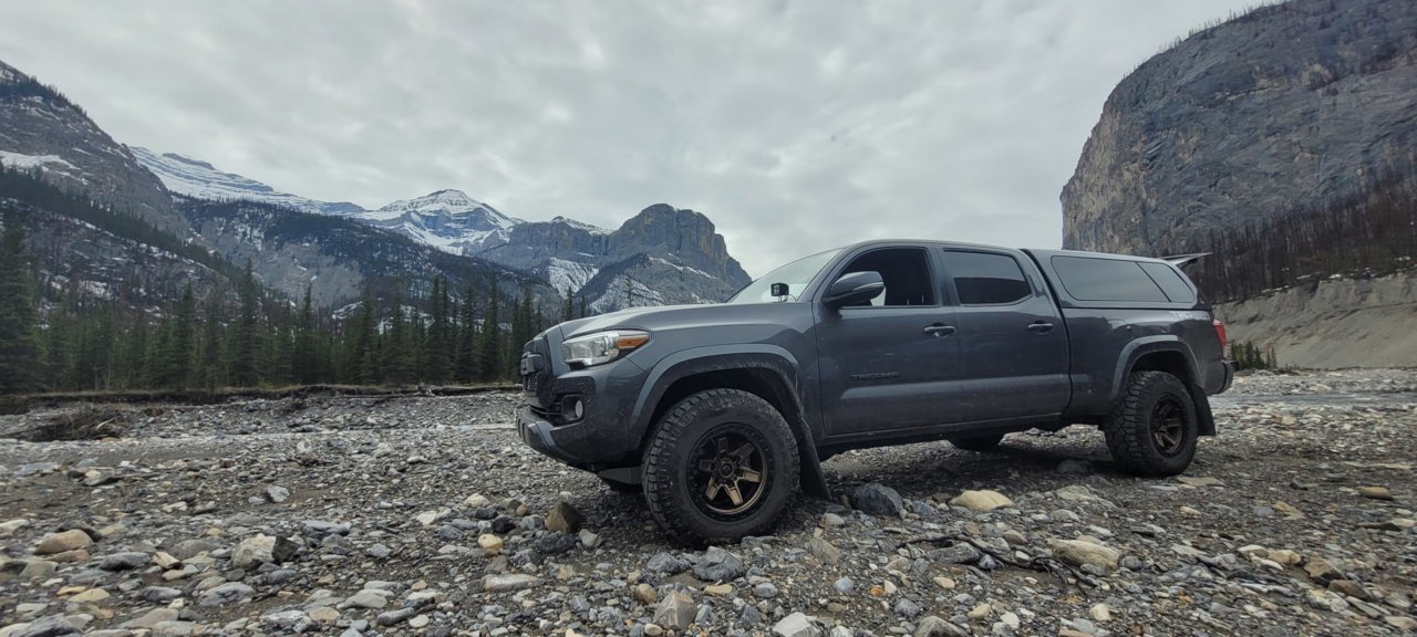

    Just for reference here's my 18 with fuel kickers 17x9 +1 and 265/70r17 duratracs in a p load rating. Some days I miss the simplicity of the set up.
    I do have a build thread that I note a bunch of my lessons learned and pros and cons of some mods thst may help save you some steps in the future.
    If you mean wheel spacers, a 1.25" would get you to a 0 offset if your stock wheels are a +33 like mine were. But if your going to look at new wheels just order them in the right offset and skip the spacers

    ya I agree. And I was talking about 1 inch lift spacers. To raise the front a tad
    not sure on the wording.
    in that picture, is that stock height? Just the wheels and tires? And no rubbing?

    18 Tacoma DCLB sport
    Wouldn't waste the money on a spacer lift.
    That's stock sport suspension no lift. It would buss the mudflap mount once in awhile while wheeling but that was it. Only at full lock and flexed. The downsides to a spacer lift outweigh the lift you get. I suggest watching tinkerers adventures videos on YouTube. He does an incredible job breaking down what you need to know about toyota IFS when lifting it.
