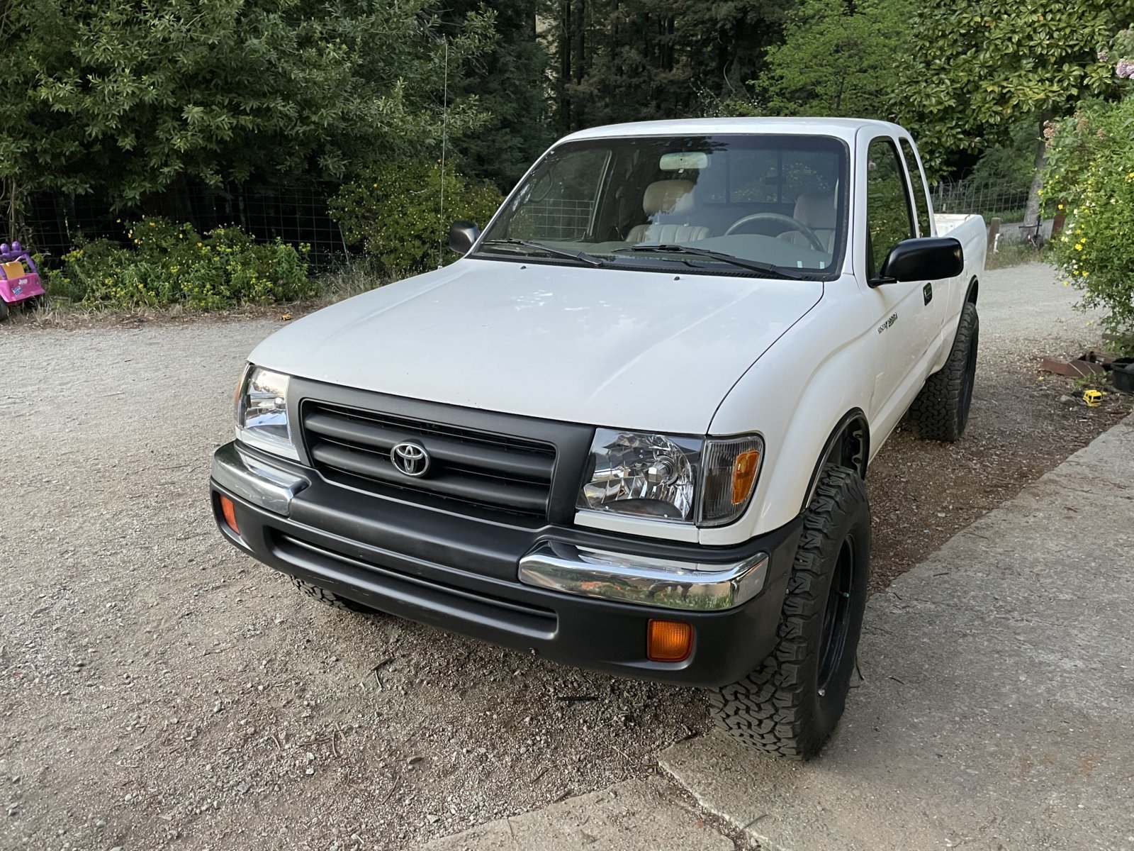

    Finally bit the bullet and bought some factory headlights from the Huntington Beach Toyota online department. They had a 20% sale so it lessened the bite. I went OEM route because numerous tries with 3rd party lights were less than impressed because of weird shadowing issues.
    However these "OEM" also had minor issues. The two side bolts were shorter than the original and was barely enough to get the nut on. I had to drill out the whole to reattach the side marker light and the spring holding the bulb in was overly long and had to cut. Since these parts are so old now is Toyota just outsourcing these parts? The headlights did come with bulbs which I thought was odd. 3rd parties do that but Toyota will charge for every part.
    Also after a test drive I noticed that the outer lenses got very hot, like 140-150 degrees with an ambient temp of 90. Is that normal? Also should I coat them with some clear coat and what would be best?

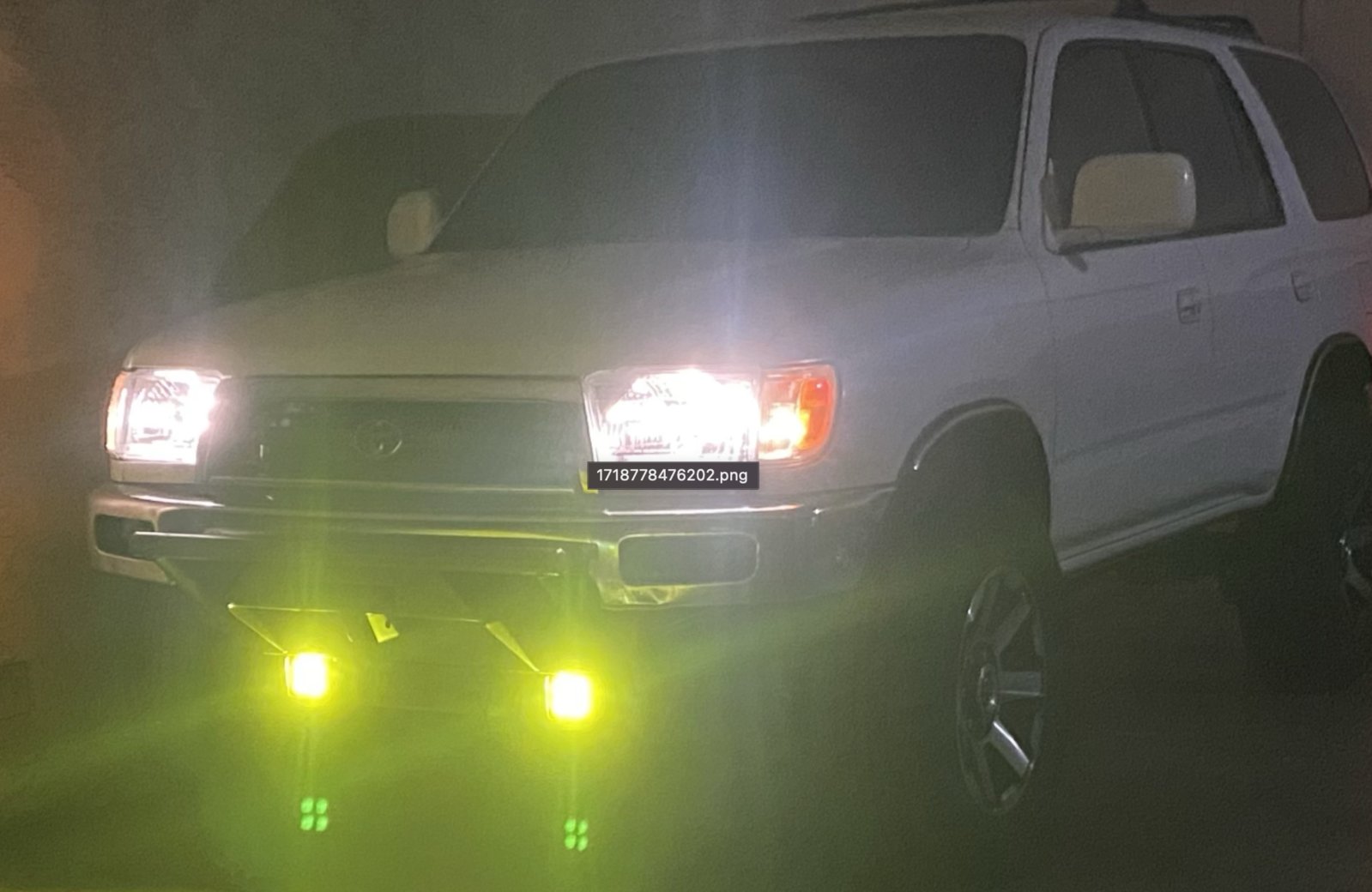

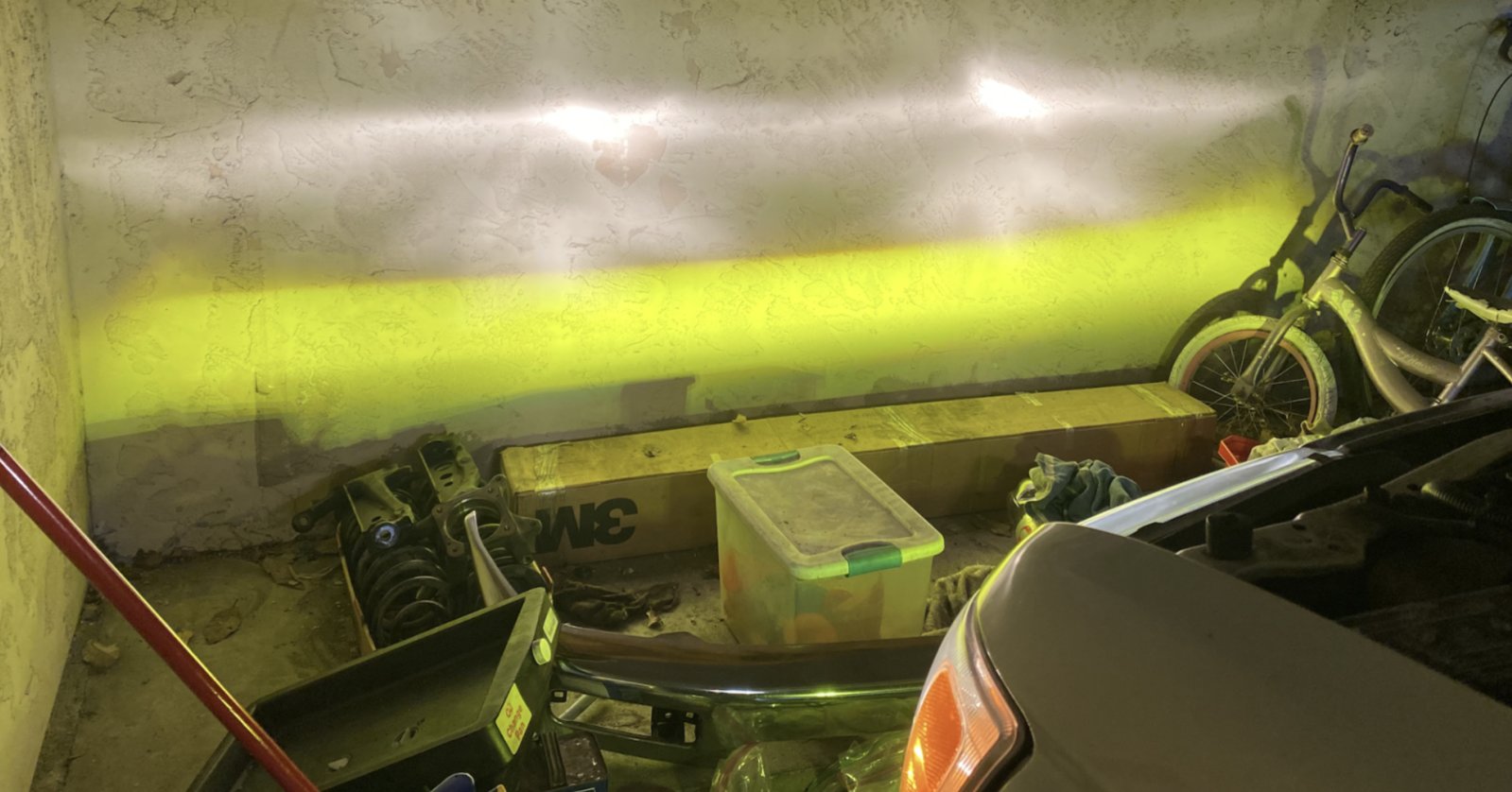

    I bought aftermarket housings for my wife's 4runner. I did a high output H4 upgrade with an Auxbeam negative switched jumper harness to the battery.
    https://www.tacomaworld.com/threads/the-ultimate-headlight-upgrade-h4-not-led-or-hid.398066/
    I added Baja Designs SAE fogs and they are a really good solution to the spotty output of the housings. I don't know how much better OEM housings will be than the aftermarket at this point - plastics manufacturing in China has improved in my experience of buying cheap housings (I bought the cheapest ones I could find on ebay for my 2nd gen and they work way better than the $80 pair I bought 8 years ago, even when those old ones were new).
    The BD fogs can be wired to come on with the headlights automatically or on a separate switch - there's a spare H4 connector on the passenger side once you do a jumper harness that I could make a harness going to the BD's so it's all removeable without any wire splices on the OEM harness.
