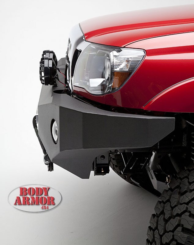

    I added a new bumper to my 2006 tacoma. This is the bumper: BODY ARMOR 4X4 2005-2011 TOYOTA TACOMA FRONT WINCH BUMPER
    I think it weighs like 225 pounds. Now the truck is uneven. I was thinking of doing a lift anyways and now i think i need to consider a lift just to level it out. Is there a way to know how much the bumper dropped the front end? I never measured it. Anybody gone through this?

    Although Body Armor rear bumper design looks decent, that front bumper design is just way too big for a midsize truck like a tacoma. Personally, there are major design flaws with it. Besides the size, other major negatives would be the weak bolt on recovery points, lack of approach angle and the small cut out to reach the winch. As long as you like it, who cares what I think. Invest in some quality adjustable coilovers for the front for lift and ride quality.

    Thanks for your opinion and advice. I will likely upgrade with 5100's front and back to help level it out. Maybe some AAL too because I do carry loads for work (I'm a stonemason). The bumper is big but apart from the weight I think it looks good. There are better looking one's out there for sure, but this one was $500 and it replaced all the damaged parts from the accident and I have a stronger front end. I'm not using the truck for driving off road just country roads and pavement. The truck is 18 years old so it deserves some love, the suspension is tired i think.
